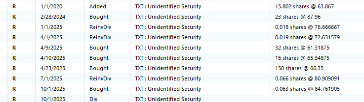

ALMOST every time I 'upgrade' Quicken something goes wrong with my data file. This time, I keep getting issues where transactions from Fidelity are assigned to 'Unidentified Security'. Also, I keep getting the red slashed '0' icon on two accounts in the account list and can't download transactions, though I've 'fixed' them SEVERAL times.

screenshotsshowing the “Unidentified Security” transactions and the red slashed “0” icon in the account list?- The symbol is correct, TXT for Textron, but its name is now Unidentified Security

@JDPINC Thank you for the detailed information and the screenshot—it really helps clarify what’s happening.
For the “Unidentified Security” issue: can you confirm if this is occurring with a Fidelity 401(k) account? If so, there is an open alert for this issue. While there’s currently no ETA for a resolution, you can refer to this Community Alert for updates and guidance to resolve it.
