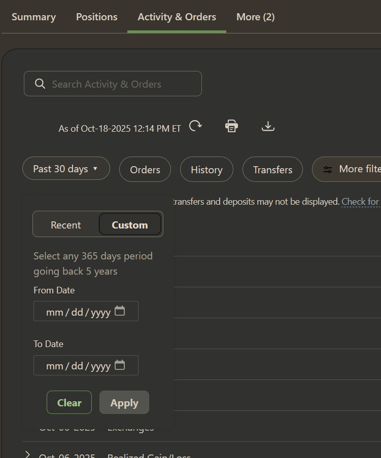

Fidelity offers the option to download 5 one-year blocks of history.
