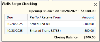

I recently noticed that I was entering transactions, balancing my account and moving bill payment dates around and all of a sudden I noticed that a transaction I entered caused the projected balances to stop calculating properly. Any transaction I enter after that will show in the projected balance but it will no longer be used in the calculations.
For instance you might have an opening balance on a certain day of $1000 and it will show a scheduled transaction of $100 and an entered transaction of say $500 (that is at or above transaction number 32768) but that $500 transaction won't be included in the math. So day preview screen shows this:

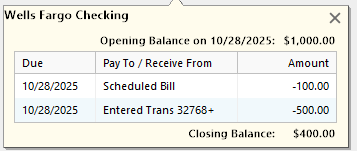

Now - if I go into the register and delete ONE transaction, it will look like this:
It's clear someone didn't code the projected balances calculations to work with transactions once they exceed 32768….

The screen shots you show are what is displayed when you click on one of the dots in the Projected Balances graph, right?

Yes, it's what I see when I click on the date but the whole graph is wrong due to the miscalculations from that day on.
