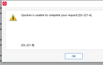

Note, the Windows installer is what I get for double-clicking the QFX. If I try to use File > Import > QFX, the result is an OL-221-A and -B

Regarding the OL‑221‑A/B errors, please see this support article for more information. However, try the instructions provided above first and let us know if reinstalling resolves the problem or if the errors continue.

Regarding the OL‑221 errors with QFX files, as mentioned in the article I linked in my earlier response:
Web Connect (Importing a QFX file from your bank's website) – Receiving this error when downloading a QFX file directly from your bank's website indicates an issue with the file itself. You will need to contact your bank to resolve this issue.

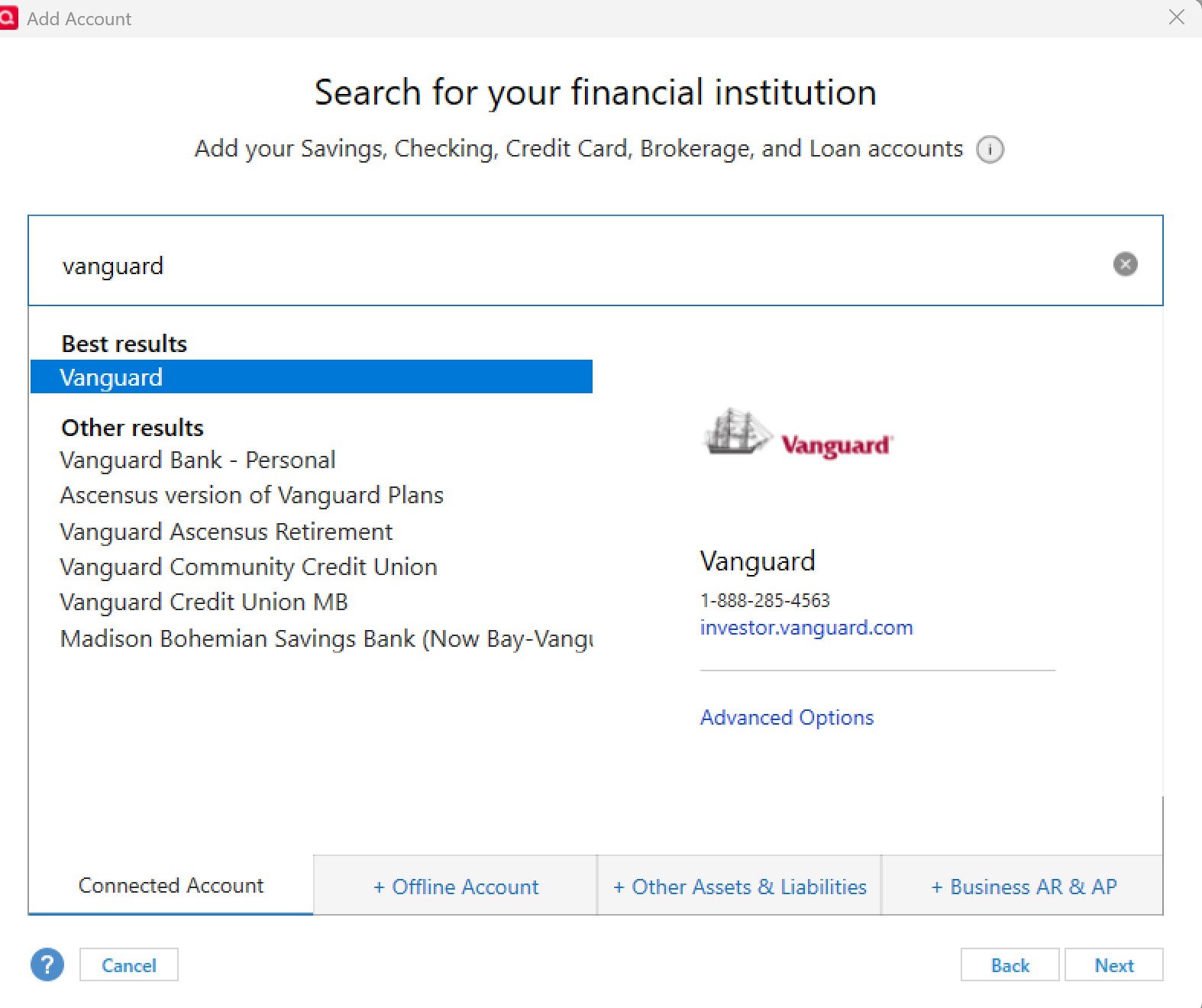

Before we do, please confirm that this is the Vanguard instance listed in our Financial Institution list that you are using, as shown in the image below:

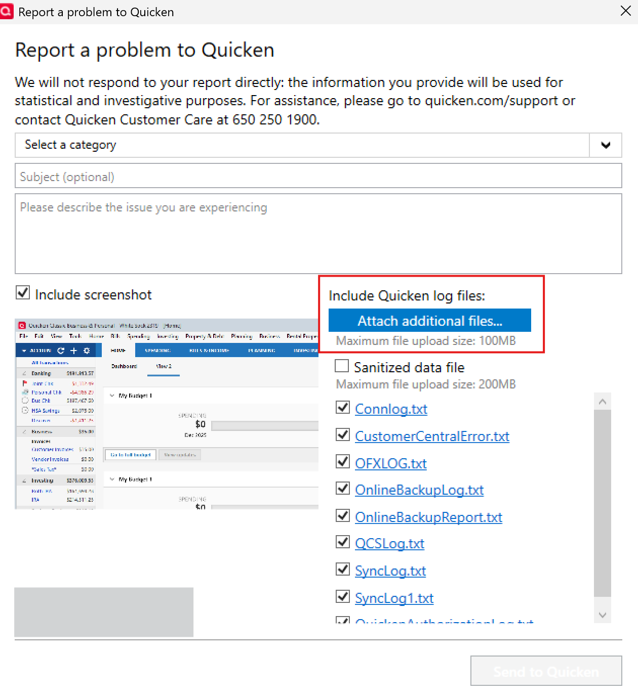

Additionally, we request that you navigate to Help > Report a Problem within Quicken and submit a problem report with log files and screenshots attached to help with the investigation.
It would also aid the investigation to include a sanitized file when submitting the problem report. A sanitized file removes personally identifiable information so you can comfortably share it with the Quicken team.
While you will not receive a direct response through this submission, these reports help our teams investigate the issue more effectively.

@SaaS_is_annoying Thanks! I’ll get your files added to the ticket. However, I noticed that only a screenshot and a sanitized file were attached. Could you also attach all the other log files as well?
That will help our teams investigate more thoroughly.

Sending now… on my first attempt the "report problem" tool was complaining about too many attachments; my guess (obviously wrong) was that the sanitized DF would have included all the others by default.
@SaaS_is_annoying Perfect, thank you! I got them all now, and will get them all attached to the ticket. 🙂

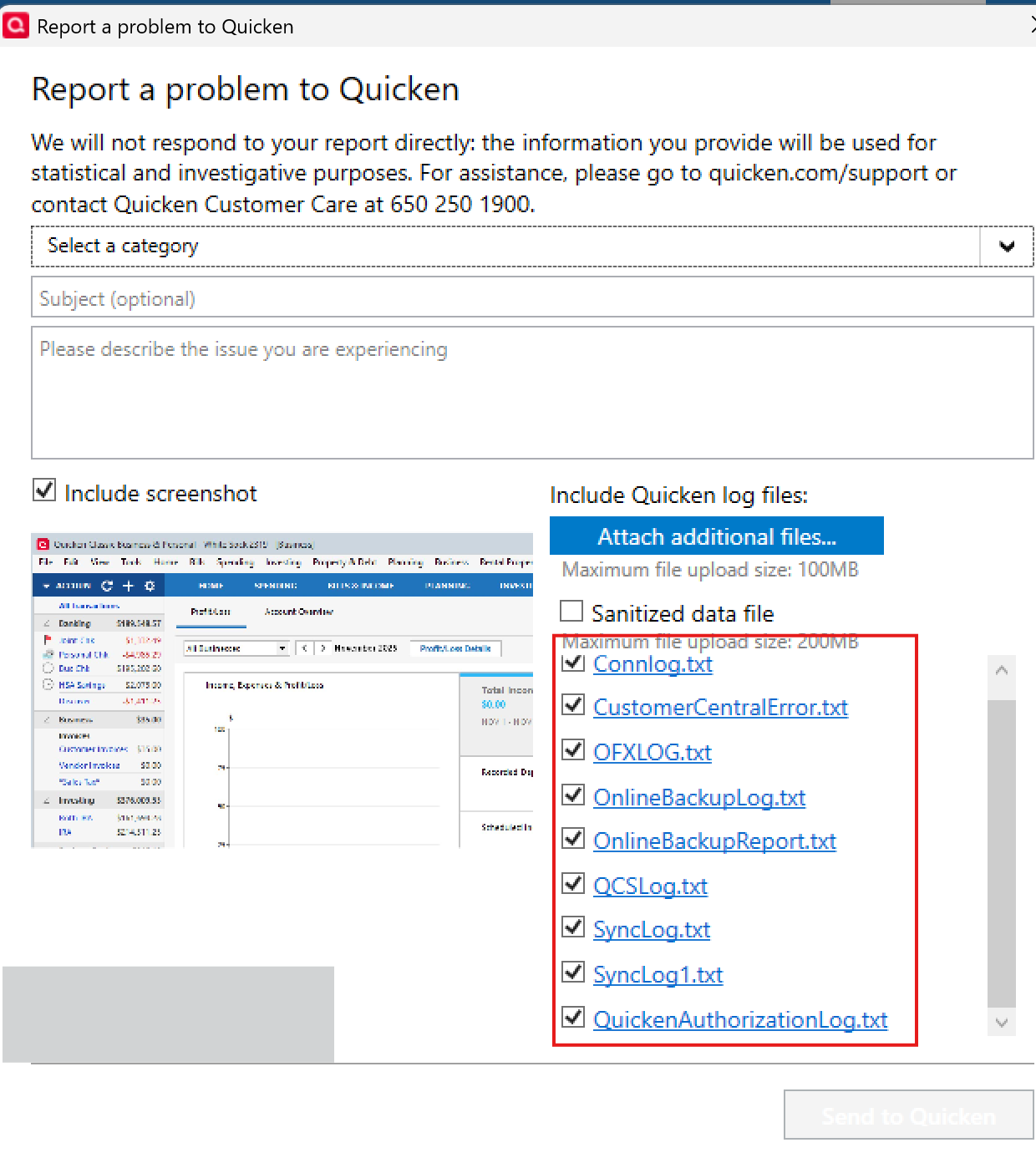

For those still experiencing the OL‑221 error specifically with Vanguard—even after uninstalling and reinstalling Quicken—and who are unable to connect via Direct Connect, please refer to my earlier response and submit your log files via Help > Report a Problem.
Submitting your log files and a sanitized data file will allow us to get your details and files added to the open ticket (CBT‑937/CTP-15383) for further investigation.

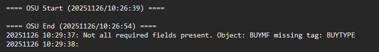

I am also having the same problem:
==== Mini-OSU End (20251125/07:30:49) ====
20251125 08:00:20: Not all required fields present. Object: REINVEST missing tag: INCOMETYPE
