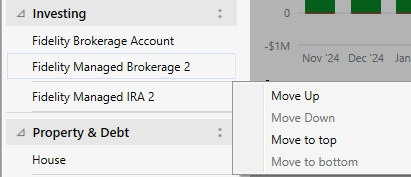

I have two Brokerage and one IRA account. I would like to put the Brokerage 2 account at the bottom which I can't. Is there any way? Options to do this are greyed out.
Go to the Accounts List. Right click on the account and use the "Order" button.
I did. I cannot move the file down. As you can see "Move Down" is greyed out.
I also cannot move IRA 2 to the top. It seems Brokerage Accounts and Tax Free Accounts are grouped and cannot move totally independently. All options for the IRA 2 account are greyed out also.
Retirement accounts are always separated from regular investment accounts. Can't change that sequencing.

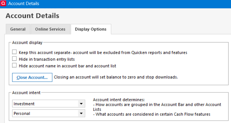

Go to the Display tab of Account Details for Brokerage 2. There you can change the Intent from Investment to Retirement. That will move Brokerage 2 to the Retirement group and it can then be repositioned in that group as desired.
BTW, changing the Intent does not change how the account interfaces with tax reports and Tax Planner. But it does change where it shows up in the Accounts side bar, in the Account List and in cash flow reports.
Just as a reminder you can do the moving up and down by right clicking on a blank spot on the Account Bar and selecting the menu option to reorder the accounts and then you can drag and drop. But for moving between sections you still need to use the intent selection.

What would work also for me is to get retirement accounts listed before Brokerage. I need to get the Brokerage 2 account on the bottom because it contains 700 securities (another subject discussed) and it takes a lot of time to scroll through them to get at a lower account. This has been discussed in another thread.
You can’t change the order of the investment and retirement sections on the Account Bar.

It is good to be cautious. The suggestion was to change the INTENT of the Fidelity 2 to Retirement using the Account Details / Display Options. That is not the same as changing the account TYPE to IRA or another retirement setting. If you try that, you should still check out that you are gettign the right tax information where and when you need it.

After doing you suggestion I found that this was not where I needed to make the change. I went to the investing page and selected "Customize > Accounts" to change the Display order. Evidently, I was rearranging the accounts in the wrong area for this display.
Thanks for the information about the Managed Account. I hadn't heard of this type of investment account strategy before. I think I now better understand what you were trying to accomplish and I'm glad to hear that you were able to do that by customizing the order on the Investing tab.
@Bione You are not in the Account List, but you are attempting to do this on the Account bar. Again,
