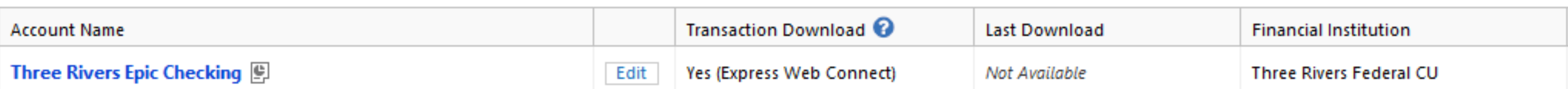

When you do TOOLS, Account List … what shows in the "Transaction Download", "Last Download" and "Financial Institution" columns across from the non-downloading accounts?

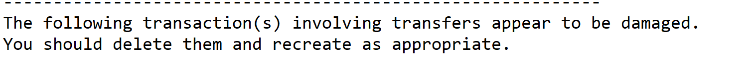

Also, have you tried Validating your Q data file? Because you MIGHT be showing signs of a corrupted file. Take a backup before you try to validate … just in case.

Here's a screenshot of one of the accounts.
I'll try validating the file. Thanks!
The validation did not say anything about a corrupted file. There were several old transactions under this:
Would these be causing the issue?

I doubt the transfers are causing your issue, but you should correct them before making the copy.
I'm a bit confused. In your OP, you say that the issue started about a month ago … but your graphic says that the account has never been downloaded, "Not Available".
Please explain. Did something happen a month or so ago? Is this a new account?Also, looking at Three Rivers in FIDIR.TXT, which records all of the connections between Q and the FI's, I see that the credit union also supports "Web Connect" where you initiate the download from their website and import it into Q. You might, on a one time basis, try that to see if it "shakes the cobwebs loose". That should work for any banking, not loan or card, type accounts.
