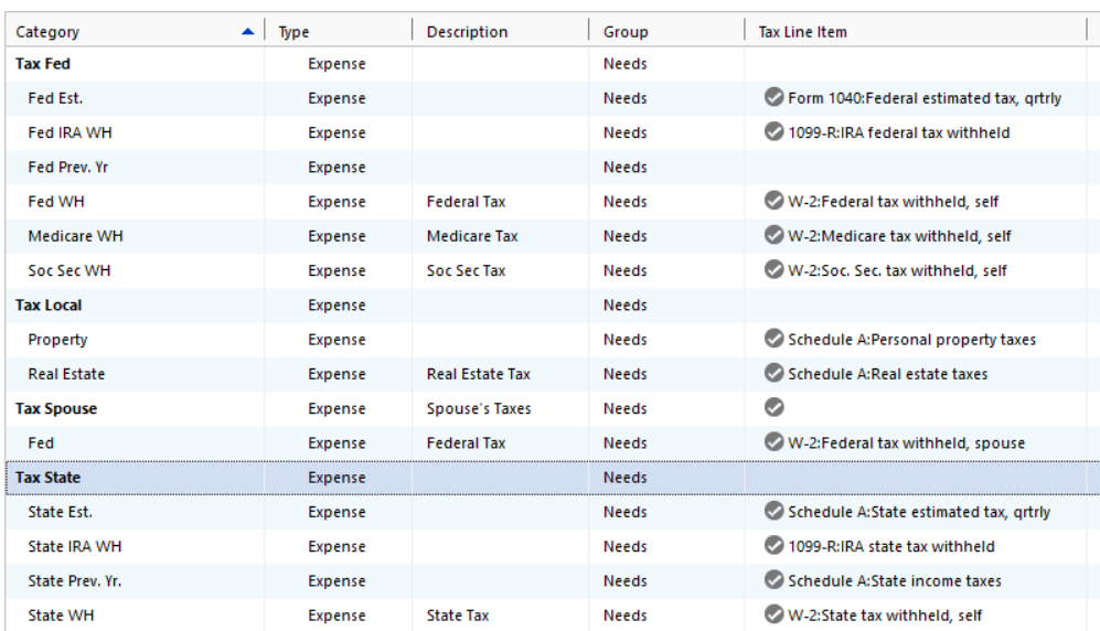

Here are my Categories for taxes
The "WH" Categories are for withholding. The "Tax Fed:Fed Prev. Yr" Category is for last year's taxes paid this year. It has no tax line item because these payments are not deductible. Note that state taxes for the previous year are deductible.
Your report settings will be different depending on whether you want to know "What was my tax liability for 2024?" or "How much did I pay in taxes during 2024?" The best way to find out your total tax liability for a year is to review your tax return.
If you don't want to make any changes to your Categories or existing transactions, you could enter a negative adjustment in the Tax Planner for the 2024 tax payment that were categorized as 2025 withholding. Go to the Withholding - Self line or wherever the payment was recorded and enter the adjustment in the detail section at the bottom.
