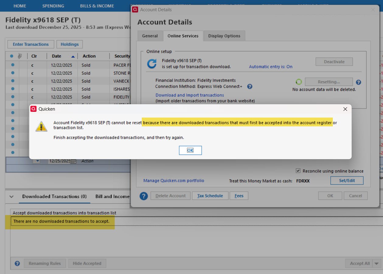

I'm trying to Reset an Account and receive the message that I must "Finish accepting the downloaded transactions, and then try again". But there are no unaccepted downloaded transactions for that account. Same thing when I try Deactivate:
I tried Validate & Repair, but that didn't help. Any ideas?

To start with, please right-click the account experiencing this problem in the Account List sidebar and select Edit/Delete Account. Then, navigate to the Online Services tab and check if "Automatic entry is: ..." is set to On or Off (see below).
Please click on it and select the opposite choice of what is currently selected. If it is set to "No - Never...", please switch it to "Yes - Always…" or vice versa (see below). Doing so should allow you to deactivate the account without getting the error message again. You can switch this setting back after reactivating the account.
Once that is done, attempt to deactivate the account. If needed, please follow the steps found in this support article to deactivate.Let us know how it goes!
That didn't work, Anja. My original screenshot showed that Automatic Entry was ON. In this next screenshot, it is OFF but the same message appears preventing an Account Reset. Anything else I can try?:
