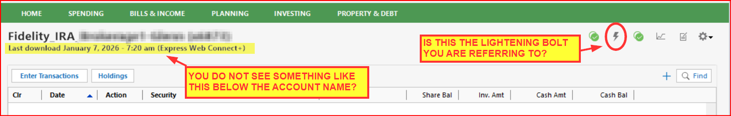

Currently, online access shows only set up and the lightening bolt on the register screen.
When I try either, they do go to access consent, then show account, don't add account, back to Q, and absolutely nothing happens-every time.
I can't delete or change anything online because the only option is setup. which accomplishes nothing.
It does not say anything about the online connection type. No error codes at this time.
So you are seeing something like this? If not, what are you seeing?
Getting a "don't add account" during reauthorization usually means that Quicken thinks the account is already connected so it will not allow adding a new connection or a new account for it.

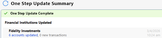

I also have been unable to download any Fidelity accounts. OSU goes through as if normal, even the bar graphs for each account and finally indicates that the download is complete. But no data since 2/27 on any account. Using latest update R66.23.
Similar problem here. I had actual buys and sells on March 3, 2026 for three Fidelity accounts, but none downloaded on EWC+. There were no error messages, and the Balances and Holdings tabs appear to be correct in the Online Center as of March 3 at 9:00 PM.
I had quite a few trades on March 3 - particularly in one account - and I will evidently need to add them manually. 😕
