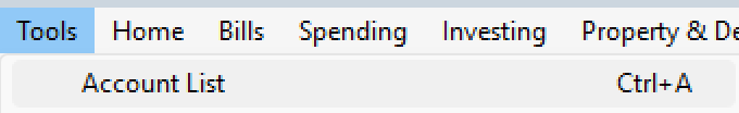

- Verify account services in Quicken:
- Go to Tools > Account List
- click Edit for your Vanguard account, and in Account Details make sure the services match what Vanguard currently provides.
