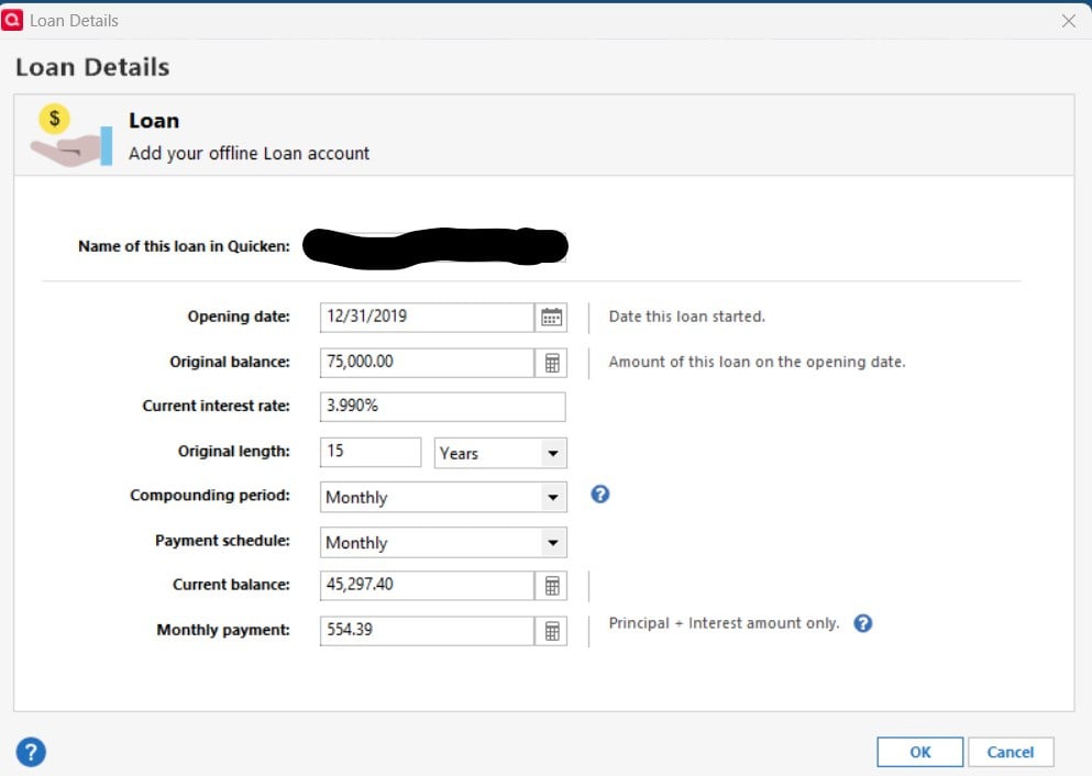

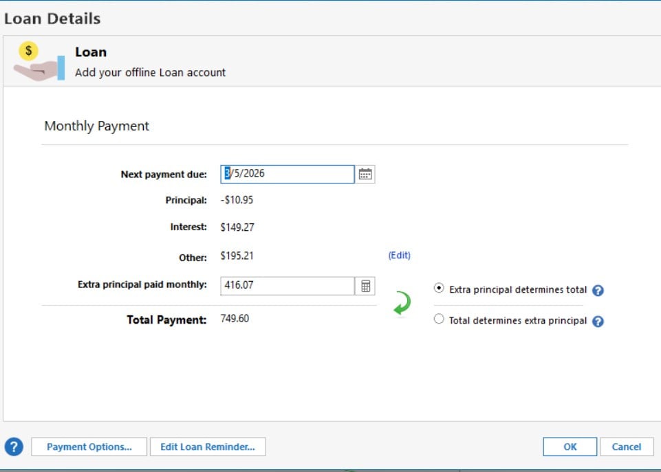

Terms of mortage are correct and Interest + Principal match statement. But Quicken is changing the info somewhere to give me a negative P & I
Payment is calculating P & I incorrectly by showing extra principal which I never put in .

- Quicken during the load process attached additional interest rates to the loan which is fixed
- Some interest rates correspond to older loans (refinancing or HELOCs) not related to this loan and predated the origin of the loan. Some dates were after the origin date.
- In addition, the escrow was now going to the wrong account, a standard expense.
What I did
- Backed up the file
- Deleted the extra interest rates
- reset the escrow to the asset account
The result - it appears that the payment is now correct and the balances match the lender.
Remaining issue - payoff date now reflects Origin date + number of years of the loan and does not reflect payoff date based on lender site which takes into account extra principal. Not a major issue but if you have an idea on that it would be appreciated. I can live with it.

The payoff date should be based off of the loan terms. Based on your screenshots, it looks like you've already double checked that information. Possibly changing it, then changing it back to the correct information again could force Quicken to recalculate the payoff date.

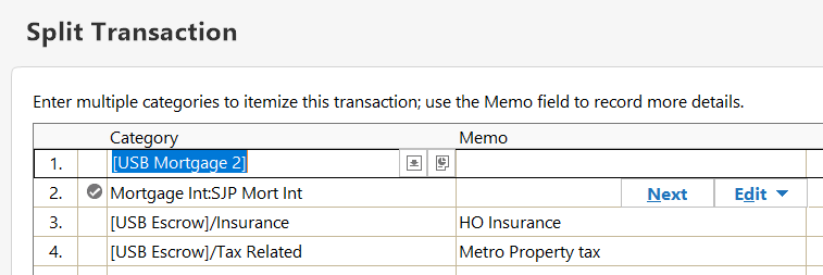

One thing I noticed in the first image you provided here was that there were multiple Splits in the payment details view for tax, insurance, etc.

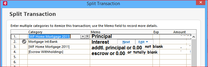

The Split transactions dialog should, AFAIK, not be broken up to include multiple entries for what needs to be paid out of an escrow account. The total monthly escrow withholding is entered as one Split line. When the mortgage company pays from escrow for tax, insurance, etc., separate transactions need to be recorded in your escrow account register.Split lines 1 and 2 are Quicken-calculated principal and interest amounts. Do not change.
Line 3 is for additional principal amounts paid every month
Line 4 is for escrow. If you don't have escrow withholding, categorize as Unallocated, $0.00
You may be able to enter additional lines beginning with Line 5, but I'm just not sure what Quicken will do with those when it comes to showing and calculating future mortgage detailsFor as long as I had to make mortgage payments, the following always worked flawlessly:
The 3rd line being Add'l Prin, or 0 is no longer required by Q. And, I have multiple transfers to my Escrow account in my mortgage payment recorded in my checking acct … but I use Tags so that I can track the amounts separately within the Escrow.
