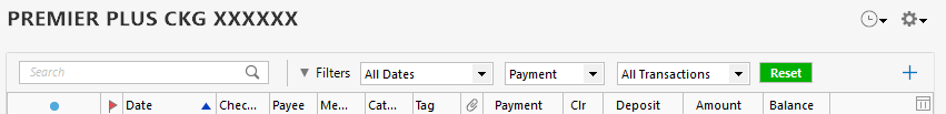

Hello @ulvy,
Thank you for reaching out! First, since the current year is showing in your register, but not last year, I recommend checking to make sure you don't have any filters active. If a filter is active, you should see the green reset button.
Click that button to clear the filters, and check to see if that resolves the issue.

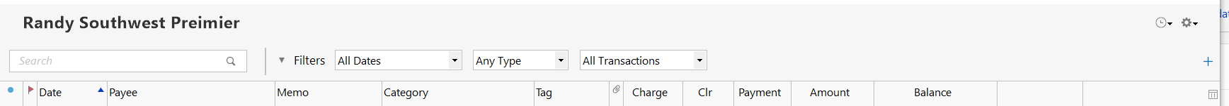

There is no Reset button on my toolbar.
I have a couple accounts that are not showing downloaded transactions. What is odd for one of the accounts I see the downloaded transactions in the Online Center. But when I click compare to register button, the register opens and there are no Downloaded transactions to compare. FYI. I did have automatically load transactions but I have also turned that off.
Also, I tried to deactivate the account based on what the chatbot assist said to try but I get a message saying the account cannot be edited because there are downloaded transactions that need to be accepted.
I also did a validate and repair. I made a backup and then told Quicken to open the backup. Nothing works.
This is happening to every account I try to update (auto download) or import a file. The accounts have the red flag but no new transactions and I can see them in the online center.
