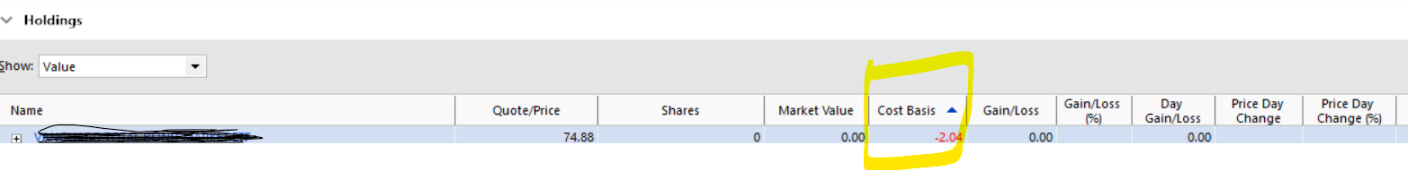

I have sold 2 different assets (entire lot) and the asset name is still in the portfolio summary with a negative cost. There is no value, just negative cost.
How do you remove it.

Yes, securities.
The securities seem to be showing due to the fact there is a negative cost basis value remaining. There is no value for the Market Value. See below. While on is a small dollar value, the other is significant (K's).
One is significant (K's).
The portfolio view is not checked for closed lot.

Did you try the things I suggested? If you did and it didn't help, then looking at a screen shot of the details of each security right before the sale that eliminated the securities might suggest something.
I think you need to go back through the history of all transactions for both securities - a Transaction report would help here - and try to spot what went wrong. I think the most likely explanation is that some transaction or transaction was recorded improperly.
Yes, I did Validate and Repair and it fixed the big one, but the small $2 one is still there. I will look at each transaction next. Thank You!!!
