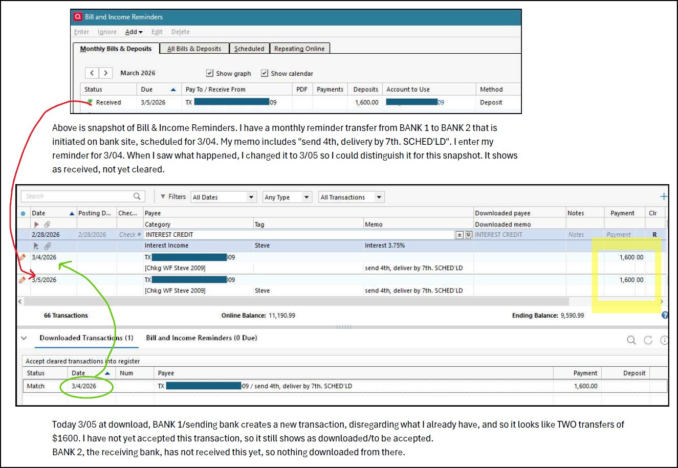

I am having a similar problem, and it's been happening for about 3 months. I use Windows version Quicken Deluxe, everything is updated. I do not use the web or download data from another source, it's all just Windows PC.
I use Bill and Income Reminders for all my routine transactions; it's sort of my budget. )Yes, I know, probably not the way Quicken is intended, but it works for me.) I have a scheduled monthly transfer from BANK 1 to BANK 2 that is initiated on BANK 1 site, scheduled for 3/04. My memo says "send 4th, delivery by 7th. SCHED'LD". I enter my reminder for 3/04. When I saw this error happen again today, before accepting/deleting the duplicate, I changed of my reminder transaction to 3/05 so I could distinguish it for this snapshot. It shows as received, not yet cleared.
Today 3/05 at download, BANK 1/sending bank created a new transaction, even including my memo. It wants to match the transaction with its own duplicate, and ignores my original entry. So, it looks like TWO transfers of $1600. I have not yet accepted this transaction, so BANK 1 still shows as downloaded/to be accepted. The receiving BANK 2 has not received this yet, so nothing downloaded from there.
This problem has happened with this particular sending bank (CIT). The first few times this happened, before I realized it, I see my balances all out of whack. Now I know to watch for it, but it's really annoying! My preferences are set to scan downloaded transactions, and to confirm possible transfers - snapshot attached for my choices. Is there some other setting I should make that will help, or is it a glitch/error that is beyond my control? Other than keeping a watchful eye.
Thank you - two snapshots included.

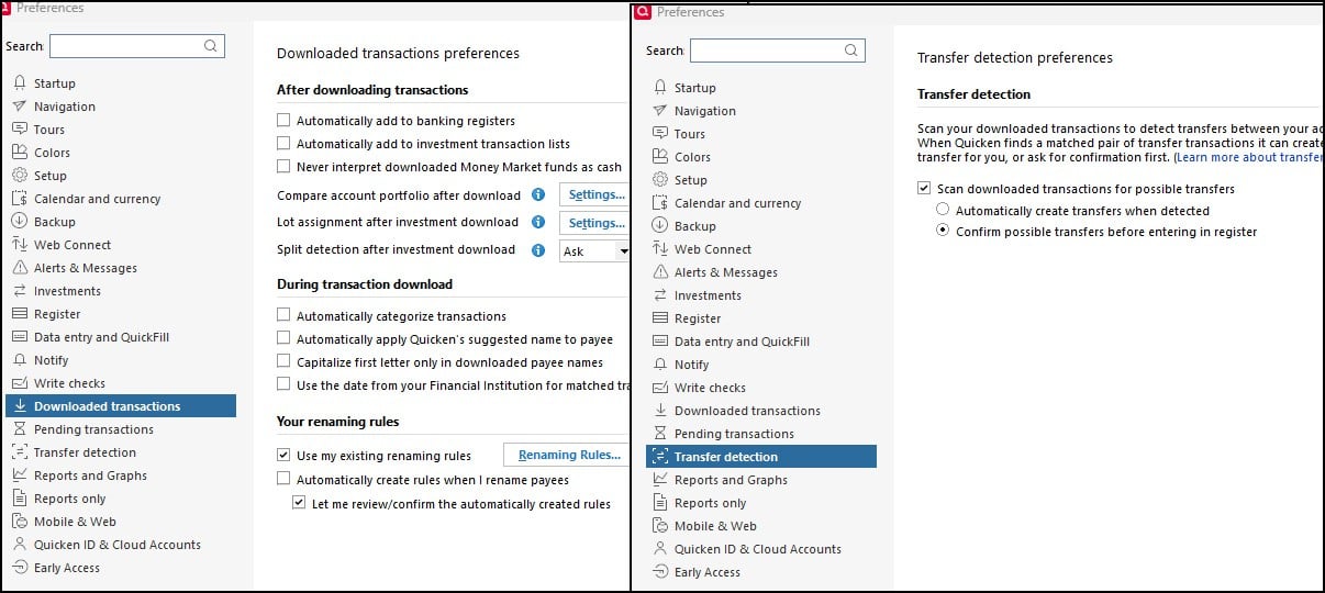

I am having the same issue. When using both "One Step Update" or "Update Now" in a specific bank account, I end up with duplicate transaction entries in the register (as described in many of the comments). This has been an issue for me for about 2 weeks. I then manually delete one of the duplicates. I am a long-time Quicken user and have never seen this "duplication issue" before.
I just disabled Transfer Detection under Preferences > Transfer detection. Will see if this solves the issue for me and let everyone know.
I am using Windows 11, Quicken Classic Premier, version R66.23, Build 27.1.66.23
March 18 update: Disabling "Transfer Detection" did not solve this issue. 😒
I confirm. This problem still exists. Disabling Transfer detection does not solve the issue.
