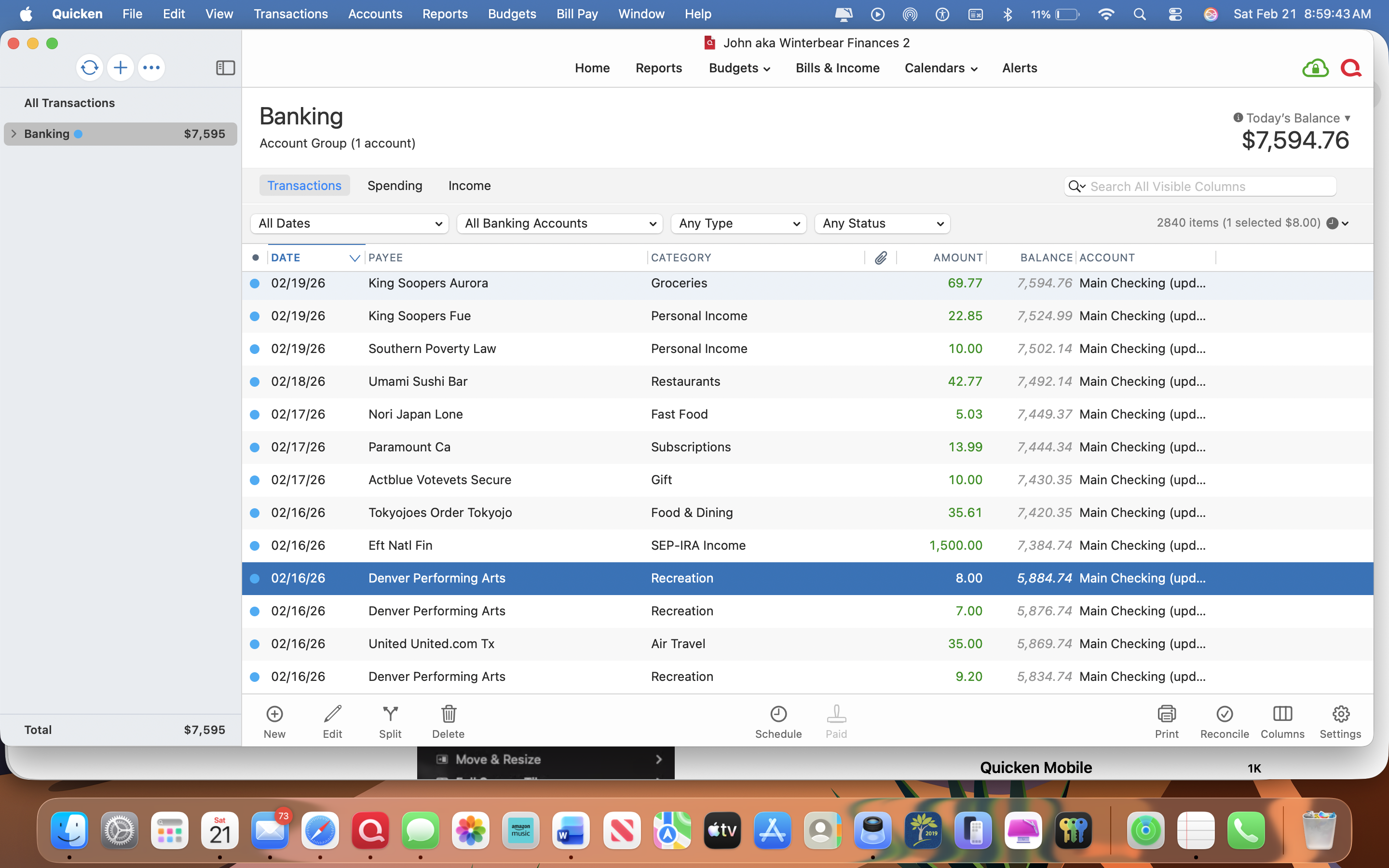

Running Classic 8.4.2 on Mac. Every update entry from Firstbank Colorado is entered as Personal Income. Every expense item is entered as income! It started at my last update on 2-19-26. I've been using Quicken for years successfully.
It seems like your bank made a change which is resulting in expenses, which should negative amounts in a checking account, being downloaded as positive amounts. The improper categories applied are a result of that.
Click on one of the transactions, and pull down the main menu View > Show Inspector. In this box, look at the bottom section which says "From your Financial Institution". These are the values exactly as downloaded from your bank, before Quicken does any manipulation of them. If the Statement Amount for these expenses shows as a positive number, then it's a fault of the bank. You need to reach out to Quicken Support to get this reported to the connectivity team (Intuit) to reach out to the bank about the problem.

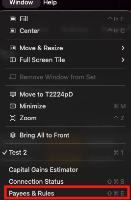

A screenshot may give you enough information, I hope it comes through here. All those entries above the highlighted one, for example, are all positive/green entries- not expense entries. I checked the Windows/payees box and it told me nothing- what do I look for? I changed nothing anywhere in the settings. I've used Quicken for years- probably 25 years? I've never had any serious glitches until now. Might this turn into a situation where I have to delete Quicken and reload it? Even with that will I have to go back and change every incorrect entry? Thank you!!

I don't have a solution here, and my gut feeling is that this issues is on the backend servers providing your download data. But, before you continue further, please note that you a viewing an account grouping-that is why your running balance is in italics.
If you click on the "greater than" sign left of Banking in the sidebar, you will be able to expand that grouping and select the individual account. Since you only have one account here, that shouldn't make much difference, but be aware of this.
After you do this so you can see that account with a valid running balance that is increasing instead of decreasing, you can then (from the Help Menu) Report a Problem and submit your data file/logs so that Quicken can push this up to their data provider.
I don't suspect that this has anything to do with Payee & Rules.

I do suspect this is a problem on the bank's/Intuit's end, but that doesn't matter to you as this is understandably a hassle. And in answer to your question, even if the problem gets resolved, it won't fix the wrong transx already in your register, You will have to manually change the sign on each in the interim.
