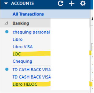

Newbie here. Just setting up my accounts, and it connected to my Libro chequing account and downloaded transactions, but it will not download transactions or show the balance of my Line of Credit.

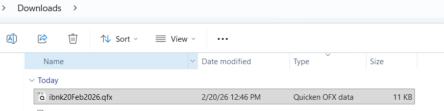

I have added a new "offline" account, downloaded the QFX file from Libro, but when I attempt to import the QFX file, Quicken cannot see it. It's seeing folders in the download location, but not the file.
Help? Did I set up the offline account wrong?

This is the transaction file I downloaded from Libro that quicken cannot see when I try to import a qfx file
Elaborate upon "cannot see". When you navigate to that folder, is it not displayed by the Import dialog?
OR, is it seen, but Q doesn't do anything with it? Or what?
And, the issue could be that even though Libro allows you to create a QFX file, they haven't told Q/Intuit to allow such. Express Web Connect, yes … but not "Web Connect" which is what you're trying.
