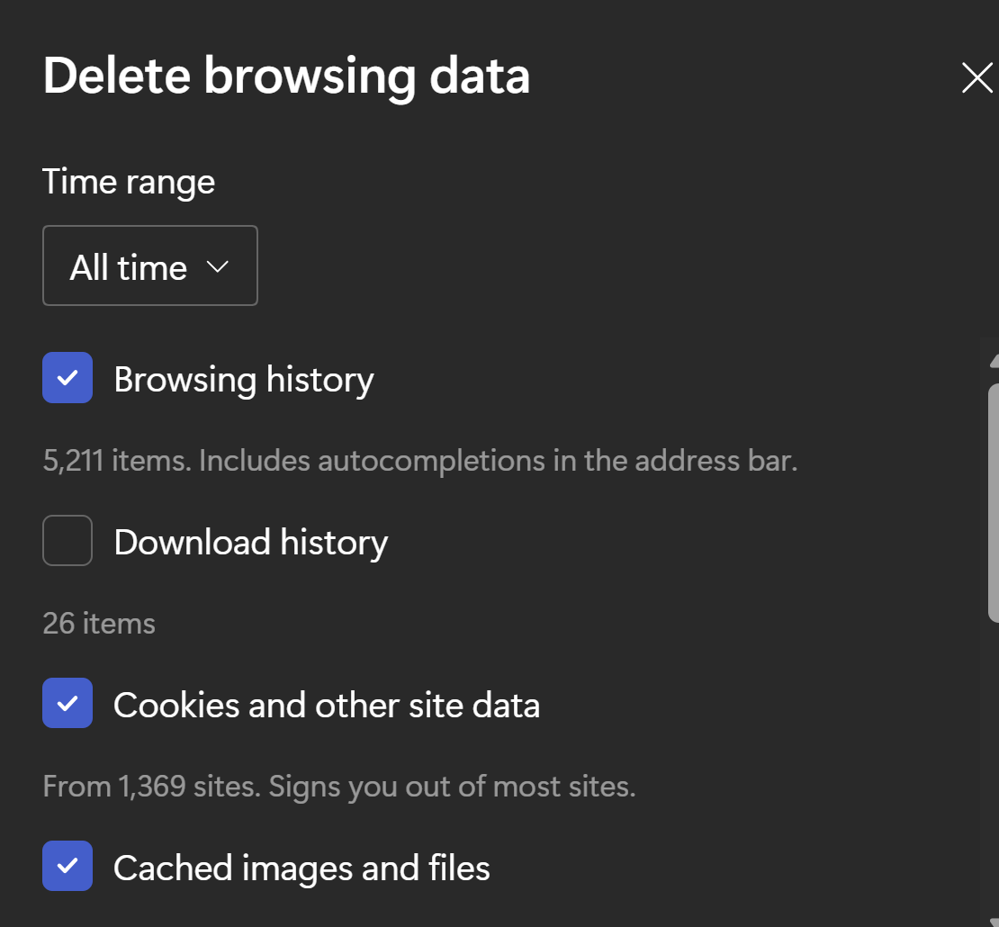

  • RalphC
    RalphC Quicken Windows Subscription Member ✭✭✭✭
    You want to clear the cache in your browser. Usually CTRL-SHIFT-DELETE will bring up the dialog. You can accept the default selections but make sure that "Cookies…" is selected. Below is the Microsoft Edge dialog box.

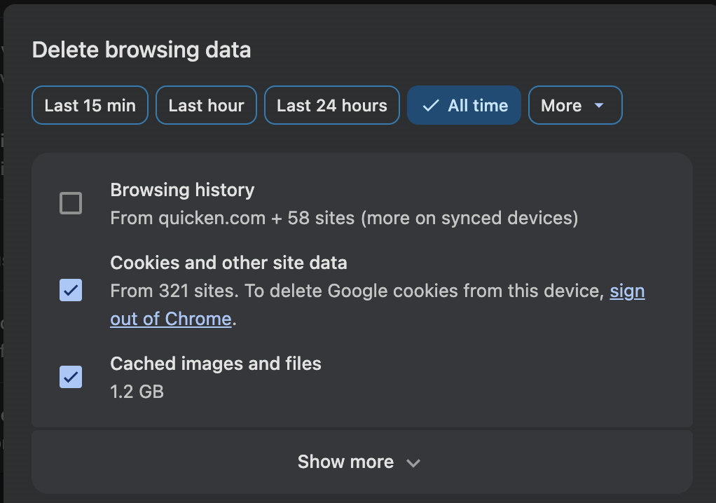

  • Quicken Alyssa
    @deern,
    Thank you for posing this question.
    @RalphC,
    Thanks for sharing what it looks like on Microsoft Edge!
    This is what it looks like with Google Chrome:
    Hope this helps!
