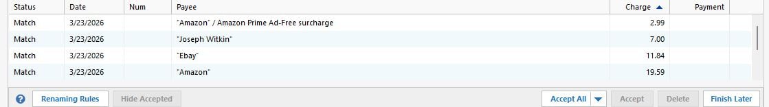

Here ya go. On completion of OSU, all downloaded transactions showed as "matched." However, in the register, it showed that they matched to newly created duplicate transactions (Amazon $2.99, WSJ $38.99- in both cases, the correct transaction is below the new bad transaction), same payee, amount, and comment, no category. Date may not have matched exactly, as bills come in randomly, but this never created a match problem before - if anything, the transaction would appear as "new" if the date was too far off. These category-less transactions were not in the register before the OSU. There are no transactions without a category in the memorized payee list.
Seems that if I delete the bad transactions before "accepting all", the downloads are then matched correctly. But that means I have to look and find them. If I just do the OSU, see that everything has matched, and hit "accept all" the way it should be, my register will be messed up.
I will upload log files. Thanks, J[Edited Readability]

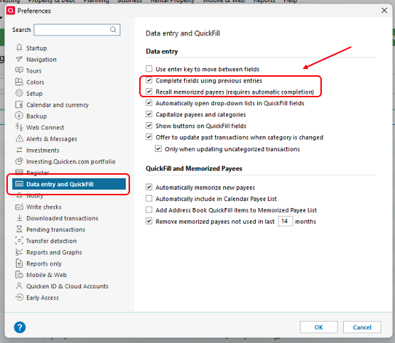

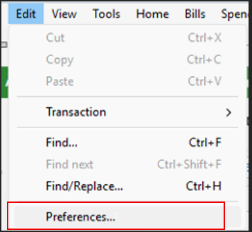

Thank you for coming back. This may be related to a settings issue, so let’s start by checking your global preferences:
- Go to Edit > Preferences
- Select Data Entry & QuickFill
- Ensure Complete fields using previous entries is checked
- Also, check Recall memorized payees

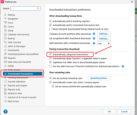

- Next, select Downloaded Transactions from the left menu
- Make sure Automatically categorize transactions is checked
- Click OK to save changes

I have all my prefs set that way except "automatically categorize transaction". Sounds suspicious for the erroneous transaction with no category… but then it shouldn't say "matched" and create a dupe, right? And if I check that pref, but have a category already entered in the transaction it is matching, will it "automatically" change what I entered? Don't want that!Again, never had a problem with these settings until recently.

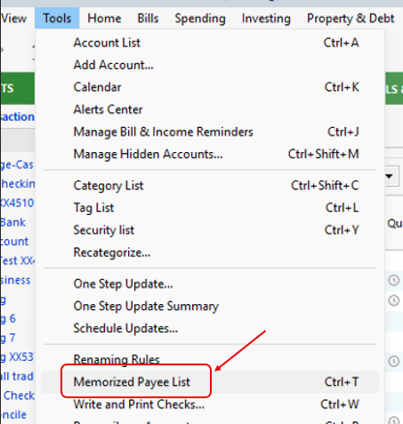

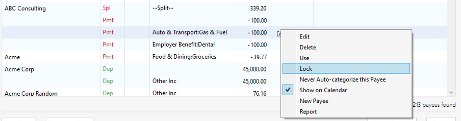

For the issue with new transactions (those not previously entered into the register), there’s another setting we can review in your Memorized Payee List:
- Go to Tools and select Memorized Payee List
- Locate the affected payees and confirm that only one category is assigned
- Right-click the payee and ensure “Never auto-categorize this payee” is unchecked
- Make sure the Lock option is checked
- Click Done, then test by entering a new transaction
