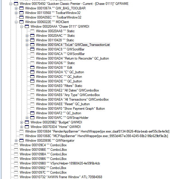

    Here is peek at the register GUI code:
    For all the non-programmers out there, these are customized/sub classed MFC GUI objects. Yes, the same GUI objects that @jtemplin mentioned that came out in 1992. And the fact they sub classed them to add their own extra functionality makes them even harder to replace.
