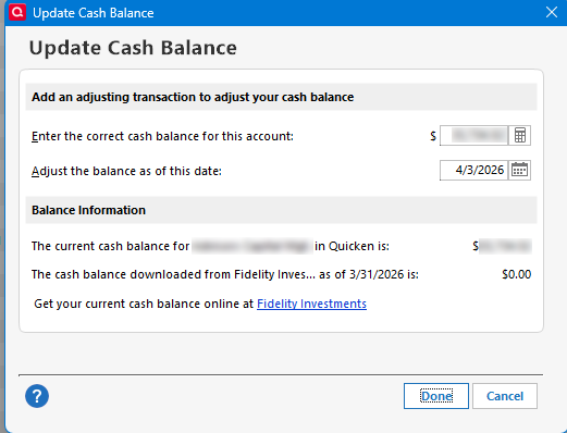

The Update Cash Balance in all but one of the accounts does not show the Cash Representation button.
The account that does show the Cash Representation says correctly that SPAXX is the cash account.

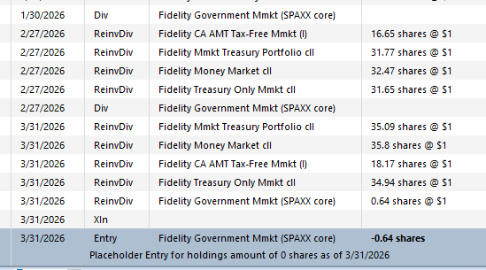

That account, like the others, was handling cash transactions correctly through February. However at the end of March it treated the SPAXX dividend as ReinvDiv; it should have been Div as before.
Note that the 1/30 and 2/27 dividends from SPAXX were properly shown as additions to the cash balance. But on 3/31 - after the issue reappeared mid-March - Quicken shows it as a ReinvDiv, treating SPAXX as a security.

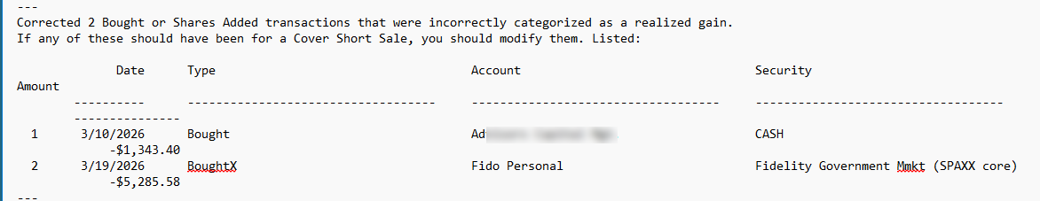

I don't know if this is a clue or noise, but I'll report it. When I did the validate - which didn't help - the error log showed (only) two transactions that were incorrectly categorized:
In the second account (which has a linked cash account), there was only one such core account transaction. However, in the first account, the Bought CASH on 3/10 was the first transaction to treat CASH as a security. But there were 8 more such transactions after that in that account. In fact, 3/10 was the first date for bogus security transactions in CASH or SPAXX in any account.
