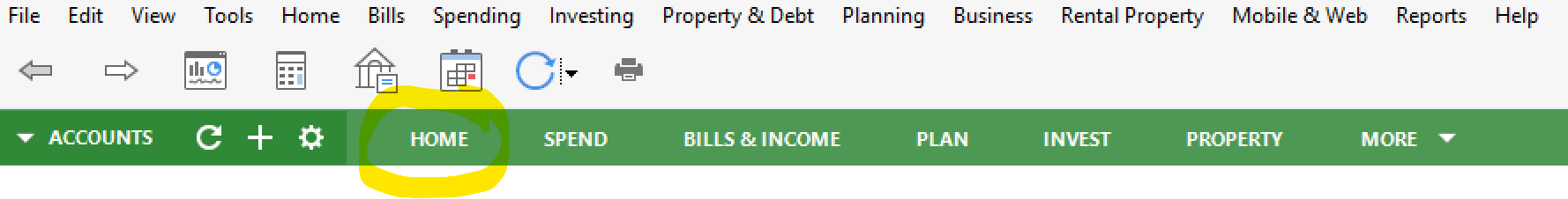

On the second quicklaunch bar whenever I hit home to get to my dashboard, Quicken shuts down
