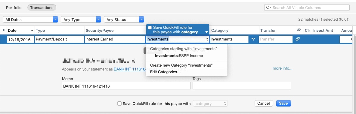

I've recently upgraded Quicken Mac 2017 to the subscription version, and figured it was about time I cleaned up my categories - decades of custom modifications (as well as the use of now-obsolete default categories from previous versions of Quicken) have made my file rather unwieldy. I would like to standardize on consistent use of the default categories which the latest Quicken defines, with only a very-few customized categories remaining for my own needs. So, I'm reviewing older transactions, and trying to change the category for most, hoping to apply the "correct" current categories, so I can purge and delete the older, undesired, and soon-to-be-unused categories.
But in trying to do so, Quicken actively prevents me from assigning categories which I know exist in the list (!). Note that my particular focus is often on updating Investment accounts (IRAs, brokerage accounts, etc.) to try and remove the obscure "dot categories" which were previously a part of Quicken (e.g. "•Div Income", "•Int Income NT", "•Long CapGnDst"), and want to change them to the current categories, which all appear to be subcategories under the "Investments" category (now "Dividend Income", "Interest Income Tax-Free", "Long-term Capital Gain").
But, when attempting to modify the Category to one of these "Investments" sub-categories, Quicken will NOT allow me to change it to one of the expected values: Trying to select from the pop-up, or manually type in the category name, will only show me the single "Investments:ESPP Income" subcategory … which is NOT what is desired. I can literally see these other subcategories in my Category list - so why don't they appear when attempting to update these transactions?

But to be clear: I am not looking to modify an existing category, or to change the predefined (and "Required") subcategories under the "Investments" heading at all. I'm actually just trying to APPLY one of those subcategories to an existing transaction - and have been stymied in this attempt, due to undocumented limitations which are apparently in place.
See the enclosed screenshot: I have the same "Investments" subcategories as you've shown in your screenshot, but am not able to apply any of them to the chosen transaction, other than (inexplicably) "ESPP Income" - which is not what is desired. This transaction also has the "Payment/Deposit" Type selected, exactly as you've indicated above.
Why - i.e. in what situations - are known categories NOT able to be applied to a transaction?0 -

Investment type categories can only be used with an investment type action, I.E. Buy, Sell, etc.
When using the "Payment/Deposit", this creates a transaction that is similar to a banking transaction and does not allow for an investment type category to be used.

@CyborgOne I can answer your last question: the "dot prefix" categories for investments date back to Quicken 2007. When the modern Quicken Mac cam out in summer 2014, it did not use those categories. So this isn't exactly new, but it's new if you've recently migrated from the old Quicken 2007.
Also, all my investment transactions did migrate to the new categories automatically. That's because the investment transaction Type determines the categories.
In the example you showed, the Type is Payment/Deposit. But if the Type was changed to Interest Income, then the category -- which is not editable -- would be changed to the Investments: Investment Income category for you.
As you've discovered, the Investments categories are used internally by Quicken, and we mortals can't manually assign transactions to them. I'm guessing it has to do with how this data is used in reporting, but I don't know for sure. But I realized I don't see the old "dot prefix" categories in my transactions, except a few where I manually coded a stray checking transaction as interest income for reasons I can no longer recall. I changed those to Personal Income>Interest Income, and then if I enter "•Int Income" in the Search box with All Transactions selected, it doesn't find any such transactions. So aside from the four "dot prefix" accounts you have which Quicken things are in use, you can delete all the others to reduce clutter. I've just left the three I have which Quicken says are in use (even though I can find only one of them in use). It would be nice if Quicken would allow us to merge the old categories into the current ones, but again, I suspect the developers are protecting the way it does certain reporting or calculationsQuicken Mac Subscription • Quicken user since 19936 -
