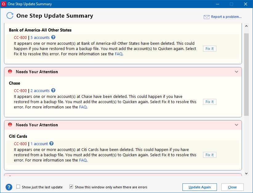

Why weekly CC-800 errors even after fixing it every week!
Every week, I get a batch of update failures with CC-800 code error. I spend 90 minutes reactivating and re-syncing to get all accounts back in good shape. A week later, I do an update, and get another batch of CC-800 code errors. I resolve again through "Fix It" and reactive, wasting another 90 minutes of my time. Same for week 3, etc. I don't have 90 minutes each week to waste on this.
It's not always the same accounts that have a problem. And from single financial institution, not all accounts are necessarily affected. Some updates show as good and ready to accept new transactions. Other accounts get flagged using a circle with a line through it.
If this does not get resolved soon, I'm afraid my 38 years as a Quicken user will have to come to an end. I cannot afford to spend this kind of time every week on something that was working perfectly fine before the last software update was pushed out. Maybe I can roll the software back and give that a try?
See attached screenshots.
