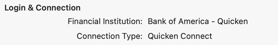

    Hopefully not adding confusion to this discussion but I have no issues with my BofA checking account through Quicken Connect:

    Hi Edmond, Were you previously using Web Connect from your bank and have now switched to downloading through Quicken?
