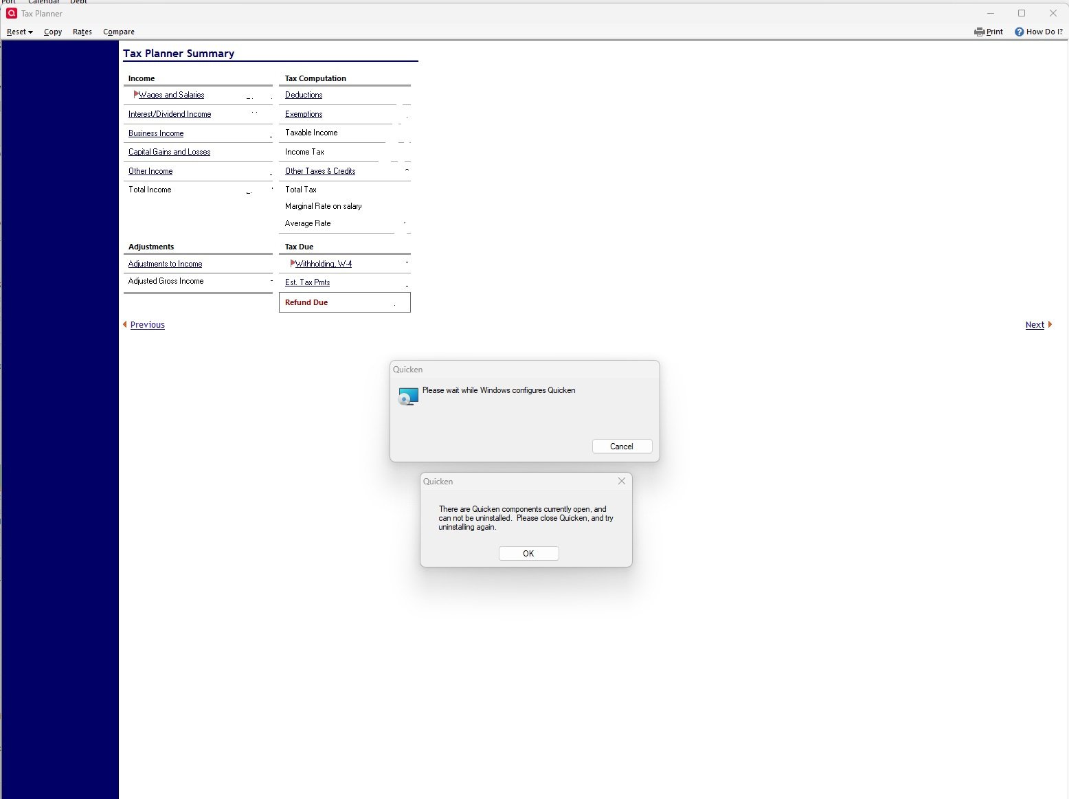

    I have the same pop-up when I open the tax planner

    To clarify, you are getting pop-up windows that say, "Please wait while Windows configures Quicken", and "There are Quicken components currently open and cannot be uninstalled". And you are receiving these prompts when you open the Tax Planner?
    Please give us the exact steps you take before receiving the prompts/pop-ups. Additionally, screenshots of what you are seeing will be helpful. If needed, please refer to this Community FAQ for instructions on how to attach a screenshot. Alternatively, you can also drag and drop screenshots to your response if you are not given the option to add attachments.

  • James White
    James White Quicken Windows Subscription Member ✭✭✭
    Hi Alyssa,
    That's correct. As soon as I click the "Tax Plan" on the menu bar I get the pop-ups.
    Thnx!
    James

  • Quicken Alyssa
    Hello @John QW & @James White,
    Thank you both for adding to this discussion.
    We do have a similar issue, where users are seeing these same prompts when trying to import QFX files. For that issue, uninstalling and reinstalling the software is what resolves it.
    I am curious if the same steps will work here. Can I please have you both try the uninstall/reinstall and let me know if the issue persists?

  • James White
    Hello @Quicken Alyssa
    Yes, uninstalling and reinstalling Quicken seems to have resolved the issue.
    Thank you,
    James
  • John QW
    John QW Quicken Windows Subscription Member ✭✭✭
    I uninstalled, but the full reinstall errored out. I deleted the install directory and reinstall worked , and then this issue did go away.
