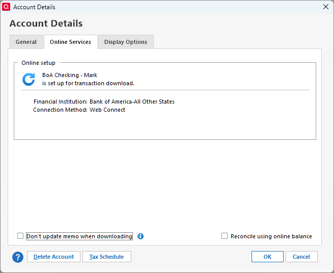

I am also having trouble with the BoA decision to drop support of certain file types, and Quicken's failure to address the issue. The solution is supposedly to deactivate and re-connect with EWC+. However, my BoA accounts are set up today with Web Connect, and there is no way (button) to deactivate Web Connect. The forced Add Account method also doesn't work because the exisitng BoA accounts don't show up as link candidates. I have searched all over for a solution, but no luck. I am running relerase R65.17, and Quicken indicates it is the latest.

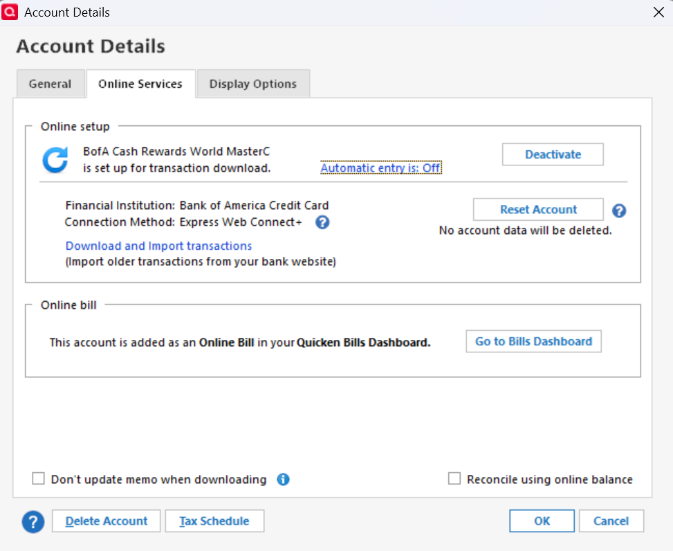

Are you looking for a button specific to deactivate Web Connect or do you not see the Deactivate button here?
If you have more than one account at BofA, you will need to deactivate all of them and then set up online services again.
I do not see (have) the deactivate button as shown in your screenshot. I do have multiple BoA accounts and plan to deactivate all of them and reconnect. But, without the button, which I note in your case is related to EWC+, I cannot deactivate anything.
Here is a shot of my dialog box:

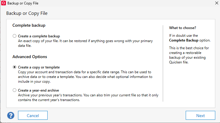

If you're not getting an option to deactivate the accounts and you also can't link to them, then there are a couple options.
- Backup your Quicken file. Navigate to Accounts>Add Account and follow the prompts. Add the problem accounts as new, since it won't let you link to the existing accounts. Then, to fill in any history that doesn't download into the new accounts, copy/paste that history from the original accounts to the new ones. You may need to close or delete the original accounts to prevent duplicate transactions in reports and to keep the duplication from throwing off your net worth.
- Create a copy of your file by navigating to File>Copy or Backup File, then select Create a copy or template. Creating a copy of your file will disconnect all connected services. In the copied file, test to see if you're able to link your Bank of America accounts to the existing ones in your Quicken file. If you are, then reconnect any other connected services, and use the copied file as your main file.
