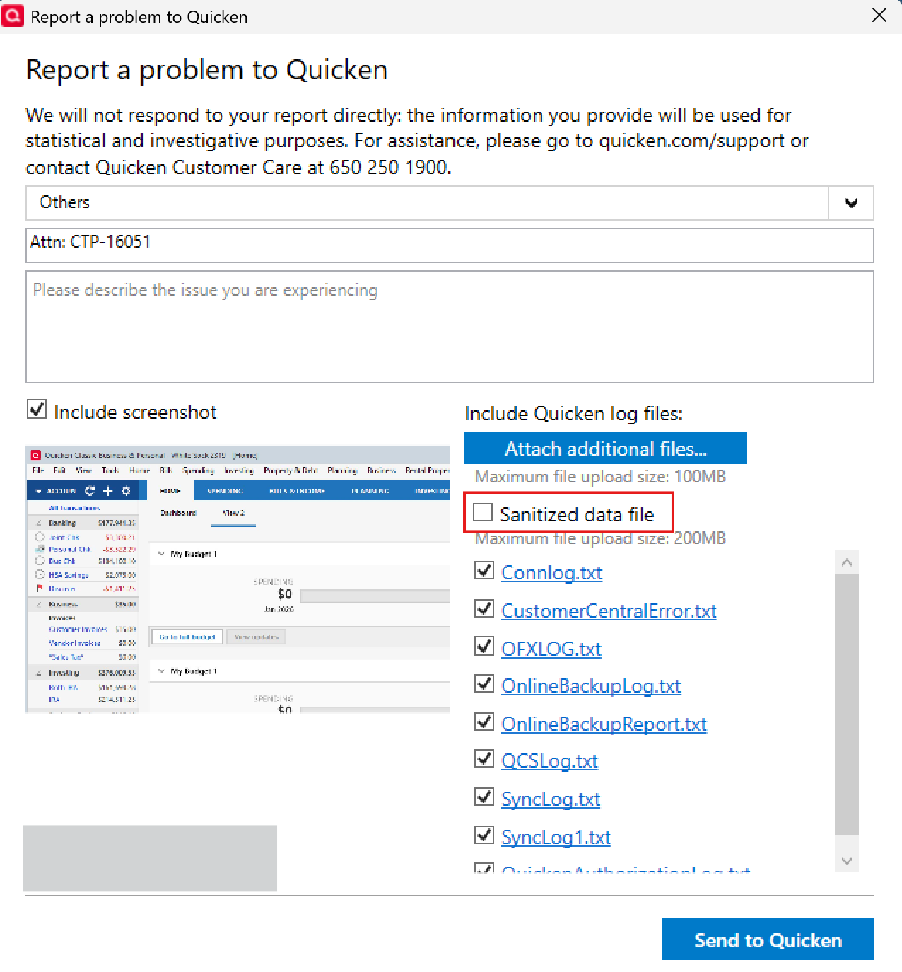

How do you create a sanitized data file?
Hello @kakits & @bjohnsonSC,
Thanks for checking in.

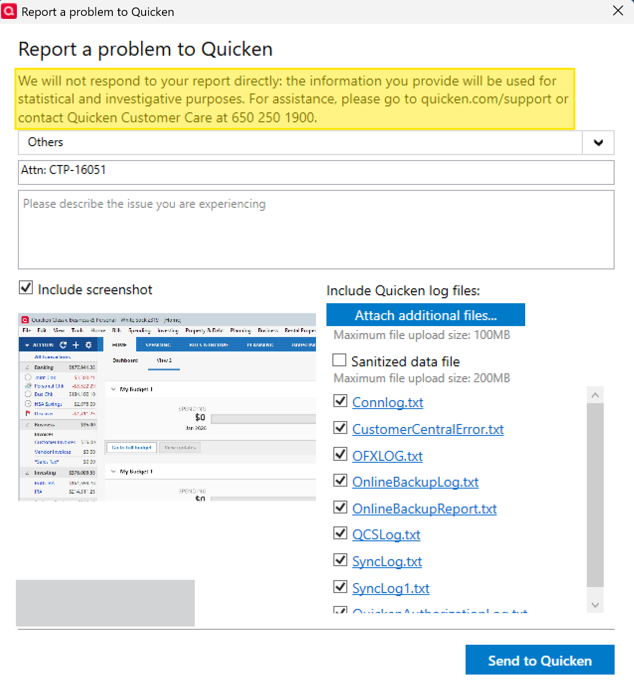

@kakits — Just to clarify expectations around Problem Reports: as noted at the top of the “Report a Problem” window, reports submitted through that tool do not receive direct responses. Instead, the logs and files collected are reviewed and attached to the existing investigation so our teams can use them during troubleshooting. While you won’t hear back individually, your submission absolutely helps move the investigation forward.
Thank you for submitting your files—we will get them attached to the ticket!
——@bjohnsonSC — To submit a sanitized data file, go to Help > Report a problem in Quicken. You’ll see a checkbox option to include a sanitized data file there. When selected, Quicken will automatically generate the sanitized file for you—no extra steps needed.

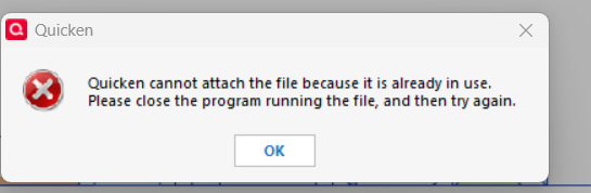

Like others on this thread, I can no longer attach a PDF to a transaction. The problem began several weeks ago. PDF files have been located on a mapped NAS drive for years (L:\Finance-2026\Receipts-misc). Moving the PDF files to a local drive (D:\Finances-2026\receipts-misc; physically located in the desktop machine) results in only occasional success. I am not using OneDrive. Running Quicken R65.29, build 27.1.65.29 on WIn11 (ver 25H2, build 26200.7623. Thank you.
