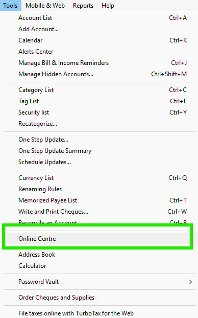

    <Right Click> on your mouse over each linked account name to "Edit/Delete account" and then select the "Online Services" tab. <Deactivate> or other equivalent button. Then go back to the "General" tab to clear the "Account Number" and "Bank Card ID" boxes (and "Financial Institution" if it is still filled in).

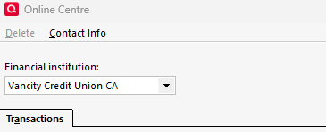

    When these steps are done for each of your linked accounts, open the Tools / Online Centre menu from the main menu bar. Vancity Credit Union CA should NOT appear as an available financial institution in the drop-down menu. If it does, you still have another account(s) connected (look at the Transactions below to see what may be still connected).
    Doing these steps seemed to reset each of my Vancity accounts to be able to download using the Web Connect process in my relevant Quicken files. Try this first before doing the manual adjustment noted in my previous post. I believe the issue was the change in account type (<ACCTTYPE>) between the two versions of the Vancity banking platform messing things up.
