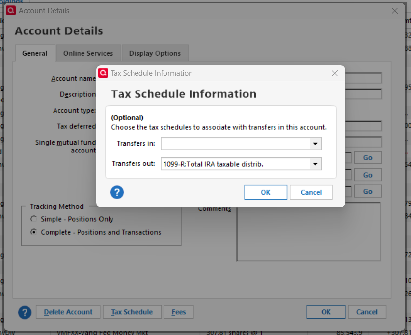

In the IRA, click on the gear at the top right and select Edit account details. Click on Tax Schedule and set Transfers out to 1099R: Total IRA taxable distrib., like this:
For the taxes to be recorded properly in Quicken, the transfer must be entered as a transaction in the receiving account. It can be a banking or an investing account, but it must be taxable, not another IRA for example.
In the receiving account:
1) Enter a Deposit transaction for the net amount of the RMD...a positive number.
2) Split the category:
- Line 1 of the split: Category = the IRA account name in [square brackets] and the gross distribution amount...a positive number.
- Line 2 of the split: Category = the Fed taxes withholding category that you use...a negative number.
- Line 3 of the split: Category = the State taxes category that you use...a negative number.
- Total of the split: Must equal the net amount of the deposit.
If you receive the distributions regularly, you can set up this transaction as an Income Reminder.
In the IRA account: Delete any downloaded brokerage transactions for
- The net distribution
- The Fed taxes withheld
- The State taxes withheld
With this setup, the taxable income will be shown in the “1099-R Total IRA Taxable distrib.” and the tax withholding in the withholding sections of the Tax Schedule report, and the Tax Planner will handle the distribution correctly.
