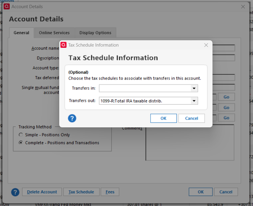

In the IRA, click on the gear at the top right and select Edit account details. Click on Tax Schedule and set Transfers out to 1099R: Total IRA taxable distrib., like this:
For the taxes to be recorded properly in Quicken, the transfer must be entered as a Deposit transaction in the receiving account. It can be a banking or an investing account, but it must be a taxable account, not another IRA for example. If there is already an Xout transaction in the IRA account that transfers money to the taxable account, note the amount and delete it before entering the Deposit. Do not try to edit the receiving end of the transfer.
