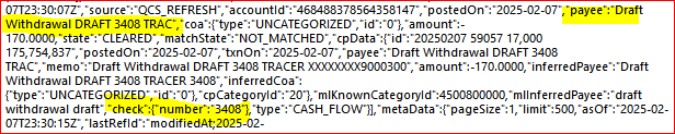

If you know how to look at the download log files to see what a downloaded check transaction looks like, it can be determined whether the check number was correctly downloaded or not.

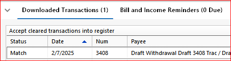

You may need to contact Quicken Support on the phone during posted hours of operation to request help and report this as an Online Banking problem.Here's a snippet from the Cloud Sync Log containing a just-downloaded check transaction. The highlighted text portions contain the payee name and the separate check number field.
The transaction now appears in the Downloaded Transactions tab as:
If in your Ally account register, the Num field is blank … that's a problem …
