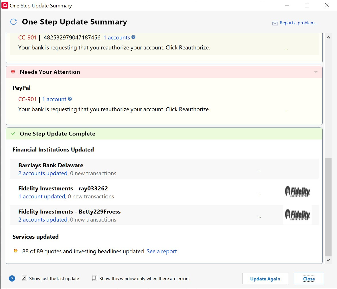

The OL-2970A error is gone, but the CC-901 messages with a reauthorization time-out continue.
I tried signing out as you suggested. I think Quicken support had me do that a month ago as well. I still get the timeout in Quicken from the reauthorization.

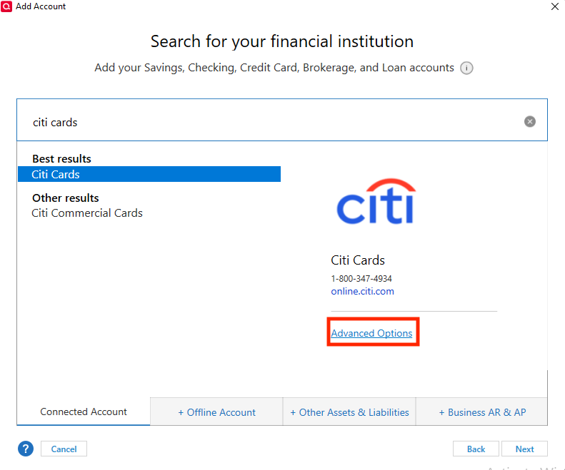

Have you tried connecting the problem account to Citi Cards using Direct Connect instead of Express Web Connect +? To do that, backup your Quicken file, deactivate the problem account (if it's connected), then navigate to Tools>Add Account. Search for Citi Cards, then click Advanced Options.
Review the information screen and click continue. On the next screen, make sure Direct Connect is selected, then click Next.

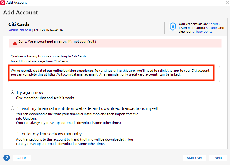

Follow the prompts to connect your account. Direct Connect often requires authorization through the financial institution website. If you get the "It's not your fault" error when trying to connect, make sure to follow the directions it provides to authorize the connection through the financial institution's website.
@Quicken Kristina , when I click "advanced options" it goes directly to the "Quicken Classic uses Intuit to Connect" dialog box. I don't get the option to choose "Direct Connect."

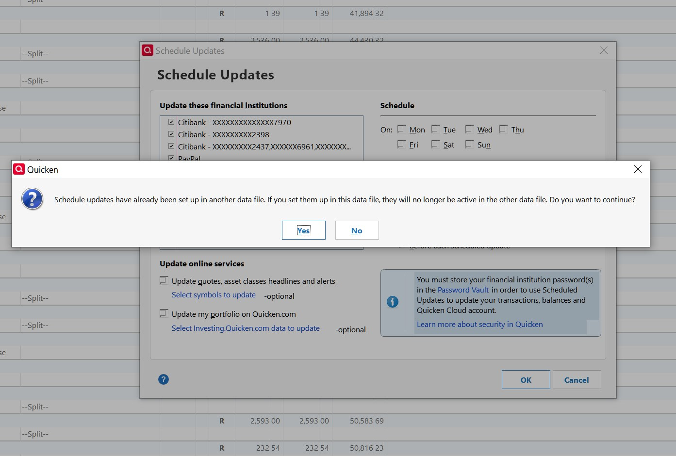

I have two data files. This morning, Quicken dropped the credit card in Citibank with savings and checking accounts. I use Citibank for all. Other's have to access their Citibank with two logins; Citibank and Citi Cards.
I think Quicken's Express Web Connect+ is the problem. It uses tokens and I think is a mess. Failure of one institution will affect others. If you have different data files, using One Step Update on one can affect using One Step on another. Usually, if I restore a backup usually all connects are deactivated. When I reconnect them, it will corrupt the original file. Repairing one affects the others. Problems ping-pong between files. This makes no sense.

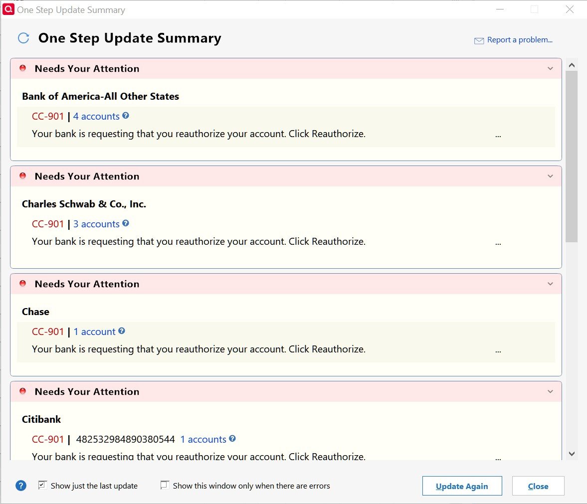

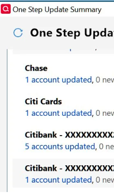

In One Step Update, I have 3 Citibank institutions: a credit card for Costco, a credit card for American Airlines, and 5 personal accounts (savings, 3 checking and a credit card). Yesterday, Quicken updated to R63.21 build 27.1.63.21. I then ran OSU and had a CC-901 error for my personal Citibank. I used Add Account and added the personal accounts back. It appeared and said it was successful but when I ran OSU again, it failed with a CC-901. This time the error was with Costco. I added Costco back but when I ran OSU again, the personal failed.
I used edit in each of the 5 accounts to Deactivated OSU. Then add them back. I ran OSU again and it was finally error free.
