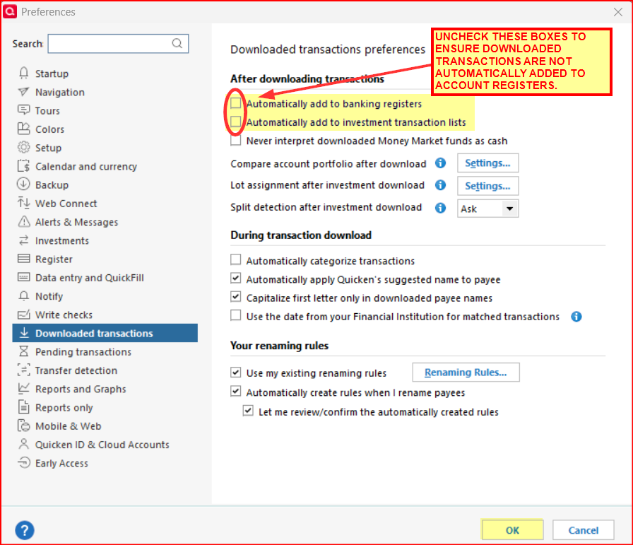

When you download an account, there is a list of the account's transactions at the bottom of the account's screen. You have to Accept the downloads to have them entered into your account, unless you set Quicken up to automatically accept all downloaded transactions. I recommend NOT automatically accepting, because if there's a hiccup in the download process (Quicken or the financial institution), all of that bad data will be added into your account and you'll have to manually undo it. It's much easier to simply review what was downloaded and click Accept All. If you do find an error, you can either try to correct it (several options for this) or just delete it and enter the correct data manually. The number of shares is probably wrong because you never accepted the reinvest dividend transactions; a similar issue is probably what is happening with your E*Trade account's cash balance.
@Ducksoup_SD How to I check to make sure I'm not automatically accepting transactions?

Go to Edit > Preferences > Downloaded Transactions > Make sure the boxes for Automatically add to… to banking registers/investment transaction lists are unchecked > OK.

Per the suggestion from Boatnmaniac I've disabled automatic the automatic banking and investment adding.
