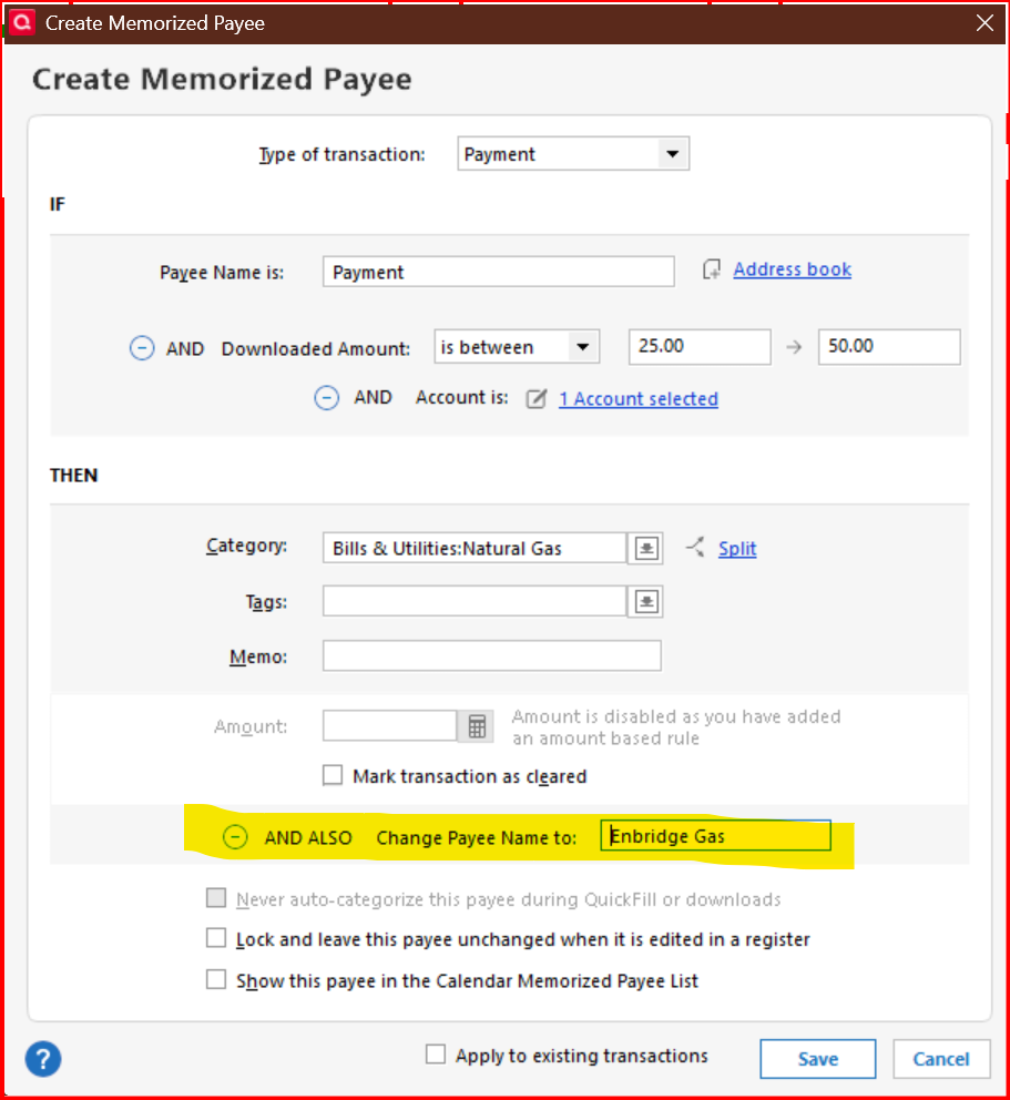

@KDP7101 would it be possible to use a Memorized Payee to change the payee name?
I haven't tested this so I am not positive it would work. But I think by using the right criteria it might.
