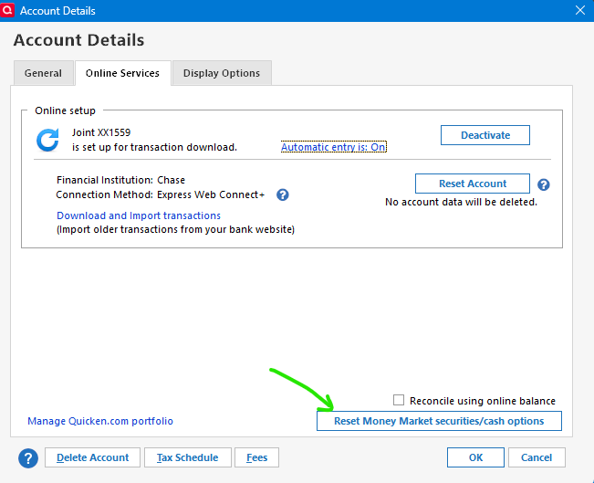

On the subject of selecting to treat it as cash as @Quicken Kristina said it is determined by the financial intuition is this is supported for a given security.

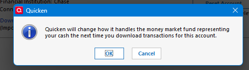

I don't have Schwab account, but my Chase account does support this, and what I see is if you go to the Account Details → Online Services tab you should see this if it is supported:
Selecting that I get:

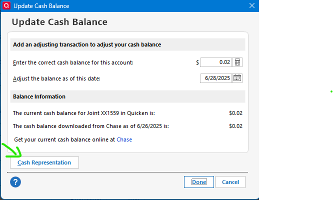

Also, in the account, if I select Update Cash Balance from the gear icon menu it shows this:

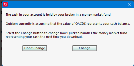

Selecting that:
