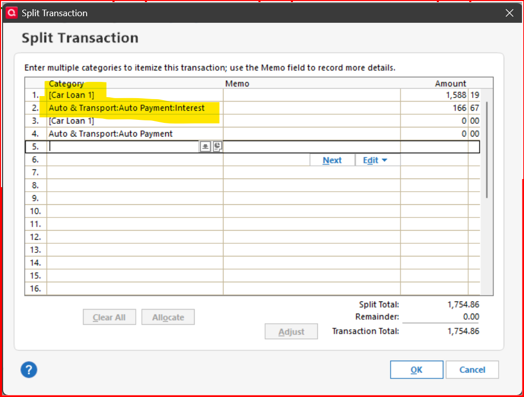

@Dick Dailey I am not sure that this is your issue, but in order for the loan balance to be updated properly, the loan payment split transaction and reminder should contain a principal transaction and an interest transaction. The principal piece should have a transfer category that draws down the loan balance, such as [Car Loan 1]. Here is an example of a loan reminder transaction -
The first split should be the principal payment, the second is the interest. When you set up a loan, a payment reminder transaction is automatically created with the four splits you see in the example. To be safe, I would make sure that lines 3 & 4 are created also, similar to the example. Quicken seems to use these splits for a special purpose and placement of the splits seems to be important.

I accepted the defaults from Q when setting up the loan. Worked great when there was only one loan. Setting up the second loan Q used the same Auto & Transport:Auto Payment:Principal category for principle. Thus the confusion.
I found the categories for the loans and changed the principle to go to those categories. I also ensure there were four category lines in each split. This worked great for CarLoan2. Still some issues with CarLoan1. But I think I now know all the pieces in play and can remedy that.
