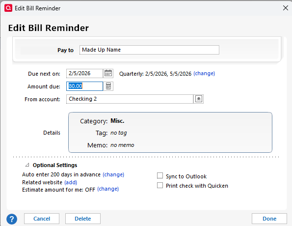

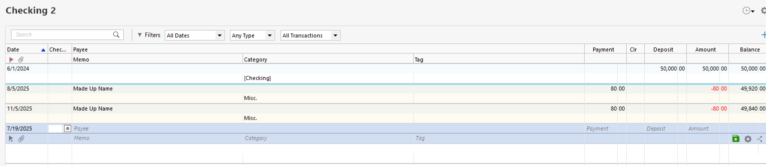

I've never used a Quarterly reminder, so in a test file I set one up, starting 8/5/25 and had Quicken enter them automatically for enough days such that I'd see the first 2 Reminders in the Checking Account. Closed Quicken, opened Quicken, and they did show up in the Checking Account properly:
And the Reminder still was using that 5th of the month date:
This is with Version 62.16 so not the "latest and greatest" version. Does the behavior you're seeing just now showing up, after an update, or is it an ongoing problem you've experienced through lots up Versions?
If the latter, that does suggest something "local" - maybe file corruption of some sort - is the problem. You might try a Validate and Repair.

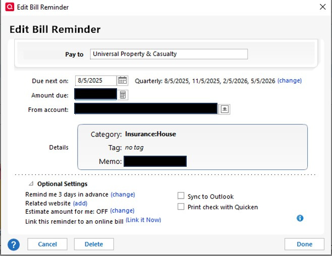

This has happened to me several times over the last few years. I can't identify any particular thing that changed that might have caused it. I will watch for it to happen again and post screen shots. Here is the current Bill Reminder,
As a workaround, if you don't want this to happen again, change the reminder from Quarterly to
Monthly, every 3 months on the 5th day1 -
