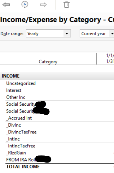

By customizing the report, I get to this type of breakdown:
Is that the report you are using or that your report is based on?
In my case, I am limiting the transfers included in the Income section to only transfers from an IRA account. But I am thereby getting ALL transfers from that IRA account shown in the income section. Additional customizations include
- Under the Categories Tab - at the end of that list of categories are a list of accounts. You may need to limit those selections such that transfers from IRA accounts are included and transfers from other investment accounts are not included in the income section.
- Under the Accounts tab - I have opted to include non-retirement investment accounts such that _DivInc and other such transactions show as income but the same transactions in IRA accounts do not get included.
If you are suggesting that you want some transfers from a non-retirement account to be included in the income section and other transfers from that same account to not be included as income, I have nothing to offer you in that direction.

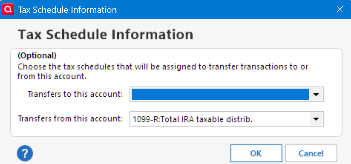

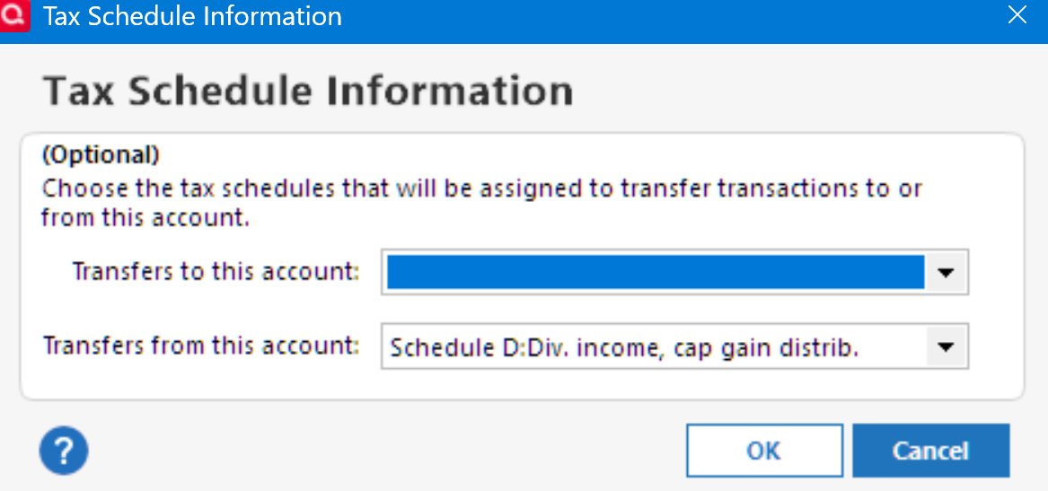

Have you selected the IRS form for the distribution in the Tax Schedule for the account(s)?
Investment account:
IRA account:
