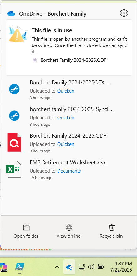

Thank you for your response. After reading your reply, I see that you are unsure of the "how" this is happening and to simply state that sometimes only certain features show symptoms is not very investigative. As you can see by the photo I attached. OneDrive does NOT sync files that are open; it simply patiently waits for Quicken to close the file. Now, if there are other files like OFXLOG.DAT, etc. that play a role in how the data is displayed, then perhaps these too can be kept open while Quicken is running, so OneDrive will not interfere.
I'd be happy to chime in any discussions your developers may need to better understand just where and how this continues to happen.Also, I cannot be the only person since CO_Cowboy in 2023 to have this happen if it is tied to OneDrive. For crying out loud, even the developers are testing against OneDrive per their version notes.

@SilverEagle I have used OneDrive with Quicken for more than a year now and I never have had an issue. One of the settings I have found that seems to make a difference is "Always Keep on this device". If you right click on a folder or file, and select "Always keep on this device", it always keeps a local copy of the folder or file on your local drive. I have selected this option for all of my folders and files in the OneDrive directory. Here is some documentation of this setting and some benefits -
"Always keep on this device" – your offline superpower
When you select "Always keep on this device" for a file or folder in OneDrive, you're telling Windows to download and store a permanent local copy, even if you're not connected to the internet. Here's what that unlocks:
Key Benefits
- Offline Access: You can view and edit your files anytime—even without an internet connection.
- Faster Performance: Local files open more quickly since they don’t need to sync from the cloud each time.
- Backup Assurance: Even if something happens to your internet or OneDrive sync, your local copy remains intact.
- Predictable Availability: Unlike "cloud-only" files, these won’t suddenly disappear due to storage management or OneDrive settings.
@Chris_QPW and @CaliQkn thank you both for your responses. Both offered good insight.
Chris_QPW, the only reason I included my OneDrive connection was because of that older article. Back in 2023, when the previous user asked the similar question, Quicken support's only response was to question whether OneDrive was used. Then in Dec 2023, according to the Release Notes, the developers released R53.26 that "addressed file opening issues from OneDrive…", so this proves that testing is being done regarding the use of OneDrive with Quicken files. I appreciated your direct response to Anja regarding alternative causes.
CaliQkn, I loved your take on this and just wanted to add that in order to see the "Always keep on this device" option, you have to enable the Files On-Demand feature within the Advanced Settings of OneDrive. I will test this out for a couple weeks and see how my experience is.Thank you both for chiming in as the user base is sometimes the best support channel!

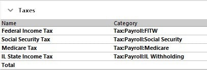

So when I created a new paycheck reminder, I used a different Company name as I wanted to see if the old company name would continue to appear in the repair log. After completing the paycheck reminder, I closed Quicken. The next day, after the Schedule updates ran, I noticed that the paycheck reminder was off again, but this time by a much lesser amount, about $300 (see attached screenshot). So I ran the Validate/Repair, and lo and behold, there are now two "Corrected scheduled transactions"; one for my new paycheck and one for my old paycheck.
I'm thinking the reason my paycheck is off may have to do with my payroll taxes categories. I use double-nested sub-categories.
Any chance this could be that root cause for my paycheck net-pay issue?
But I am still curious why my old paycheck is still showing up as a scheduled transaction in the Validate/Repair log. I looked at my Projected Balances tab and set the Time Range to 12 months and I do not see any transaction listed with the original Company name I used prior to recreating my current paycheck. Thoughts?0 -

- The net paycheck discrepancy could potentially be influenced by how your payroll tax categories are set up, especially with nested sub-categories. Complex category structures sometimes interact unexpectedly with scheduled transaction calculations, so this is a valid hypothesis.

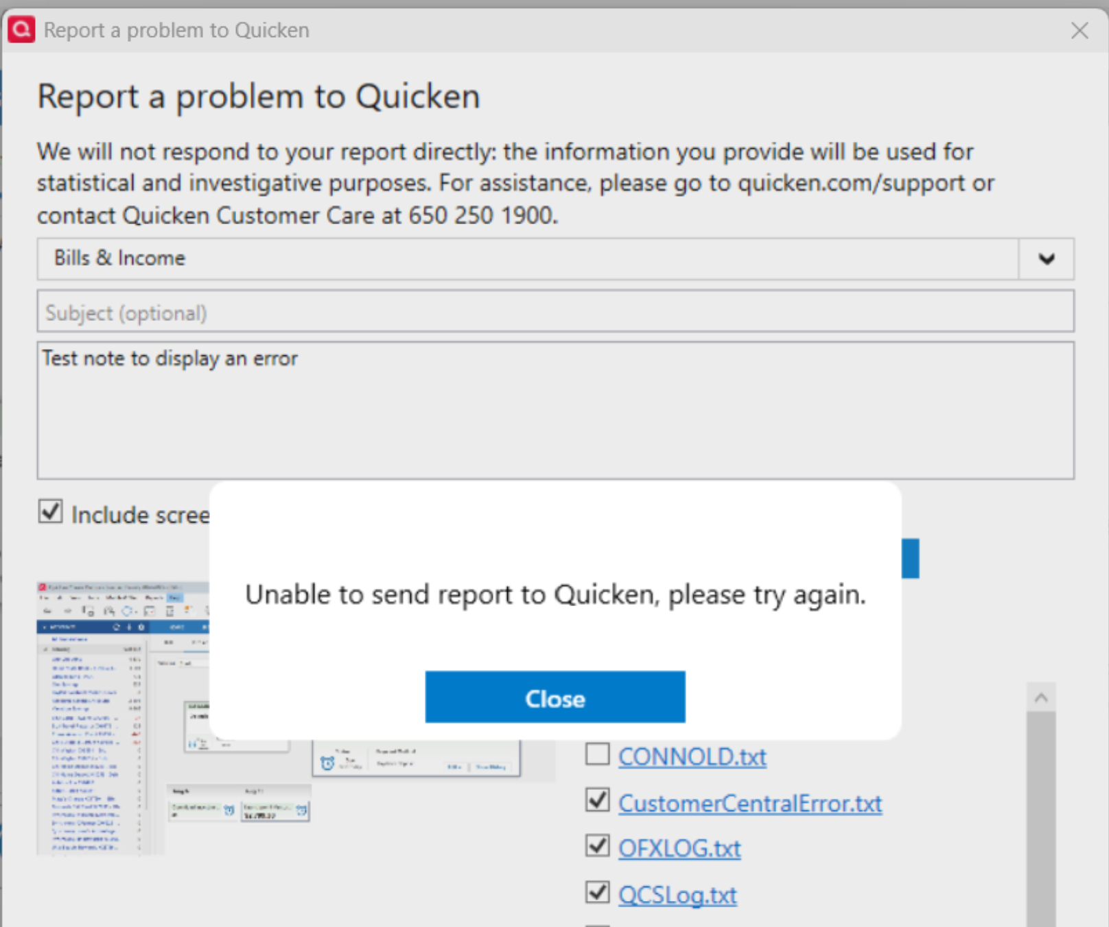

Anja, I would love to use the Report a problem feature, but I have never been able to make it work. I even upgraded this PC to Windows 11 and it still doesn't work. Any assistance would be greatly appreciated.
Thank you for your reply @SilverEagle,
What happens when you try to use the Report a problem feature? Are you seeing any error messages when you try to report a problem?
I look forward to your reply!
This is what I get.
[Edited Screenshot to Remove Email]
@SilverEagle Thanks for letting us know! In some cases, the Report a Problem tool may work if you try submitting each log individually—so instead of selecting all the checkboxes at once, try selecting just one log file at a time and submitting them one by one.
If that still results in the same error you've been getting, let us know, and we can explore other ways to collect and submit the necessary information.
