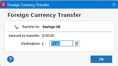

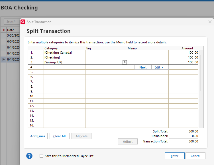

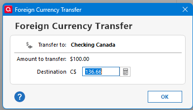

Quicken currency support doesn't allow for having more than one currency in an account.
Any transaction, including split lines that affects a given account has to be in that account's currency.
The only transaction/split line that would be a bit different is a transfer to another account that has a different currency. In that case, Quicken will ask about the destination amount for each transfer going to an account with a different currency.
