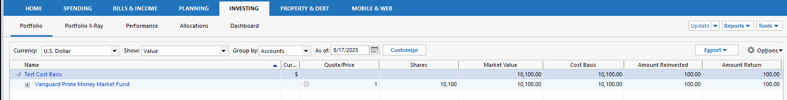

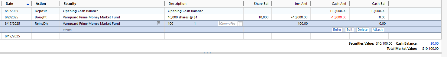

To keep this simple I'm going to use and example where the NAV doesn't change. Below a buy of $10,000 followed by a $100 dividend that gets reinvested.
The Cost Basis is $10,100 and the Amount Returned is $100.

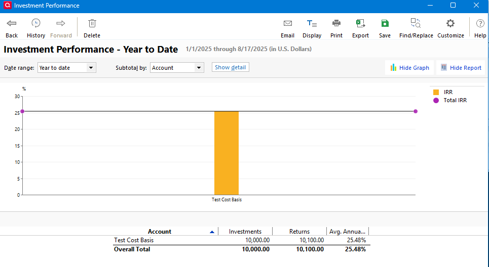

I pull up the Investment Performance report:
Now you see the starting $10,000 and the ending $10,100.
