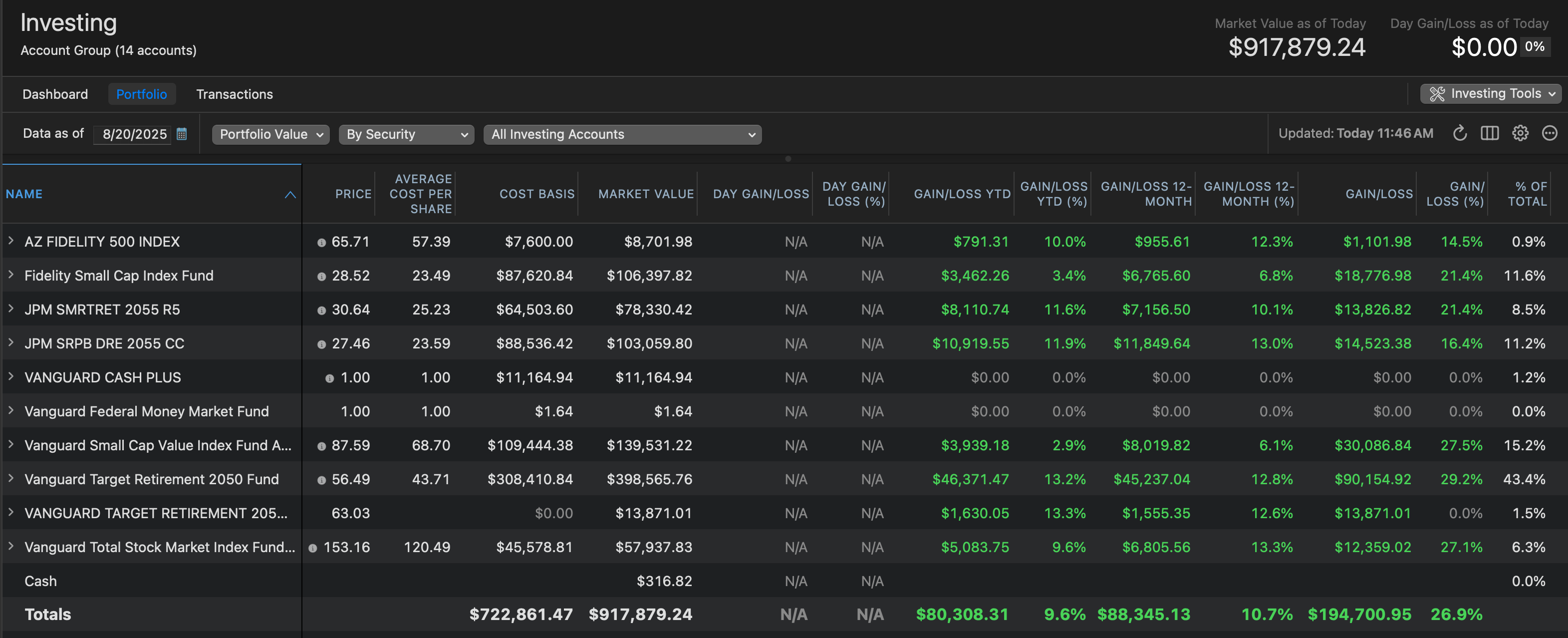

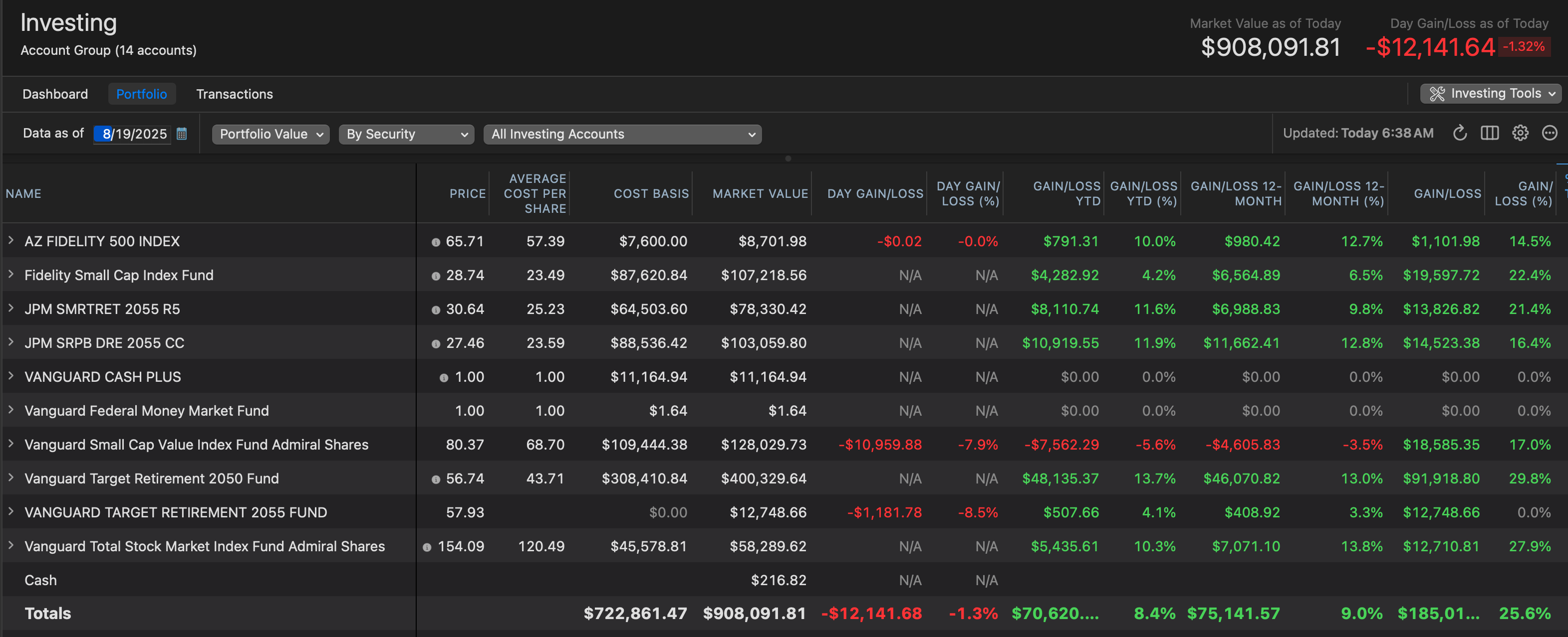

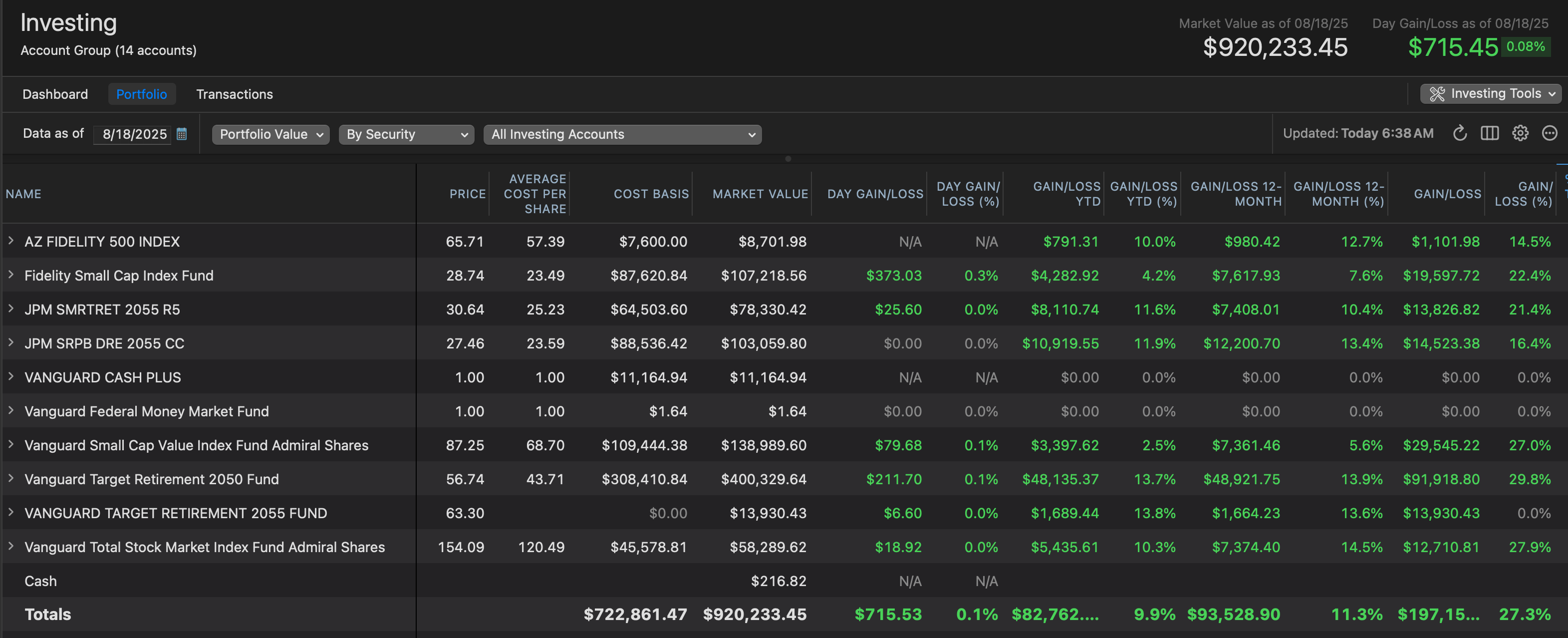

Thanks Kristina. Attached are two screenshots. The first is how the markets ended last night 8/18/25. The second is how my accounts look at 6:40 am Pacific time the following morning.

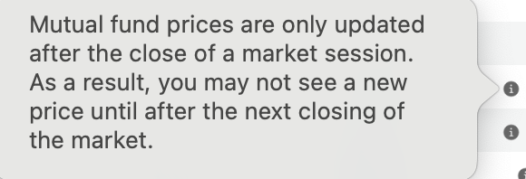

What's odd is that two of your Vanguard mutual funds — Small Cap Value Index and Target Retirement 2055 — do not show the little "i" icon to the left of the price on the second screen shot; it is present on your other mutual funds. When you click that little "i" it shows:

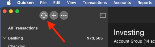

@John_in_NC thanks for your continued help. Here's some new info from today. I hadn't touched the software at all this morning and just took a look at it. You can see the updated time at the top right (11:46 am) that is happening automatically, but the values of my investments are all still normal. I took this first screenshot and then clicked the main update button at the top left of Quicken, and this specifically caused the issue at hand (screenshot 2). So, it does appear to be 100% related to the update button in screenshot 3. Am I reading your final statement correctly that with this being the cause, the issue is coming from Vanguard?
