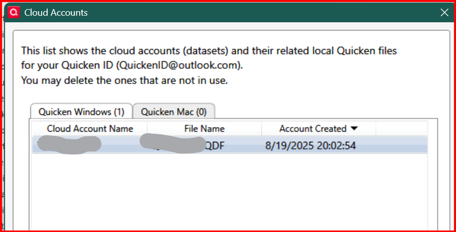

    Also, if a Quicken LifeHub user can confirm if they also see a "phantom" cloud file when they click on Edit → Preferences → Quicken ID & Cloud Accounts. It says I have 2 cloud accounts associated with my Quicken ID, but when I click into it, it only lists one.
  • This phantom cloud account is very troubling.

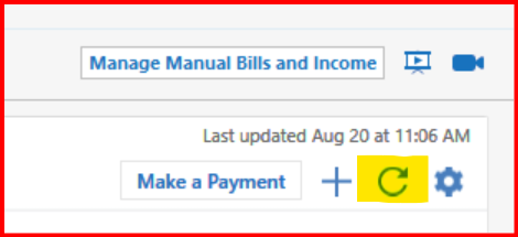

     I don't use Online Billing, but I clicked on "Update All" in the Bills tab
    I take that you mean that you are using Bill Presentment, but just not paying bills with this system?
    Because if you were not using the online bill system at all, you wouldn't have an "Update All".

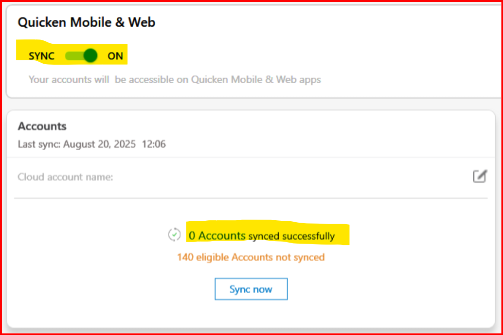

    Sync to Mobile/Web - yes it's on at the global level, but no individual accounts are selected -
    Online Bill (presentment) - NO - all of my bills are automatically deducted by the biller. I do not use bill pay or any kind. Here is the "Select All" button I was referring to -
    Pending Transactions - NO - never have.

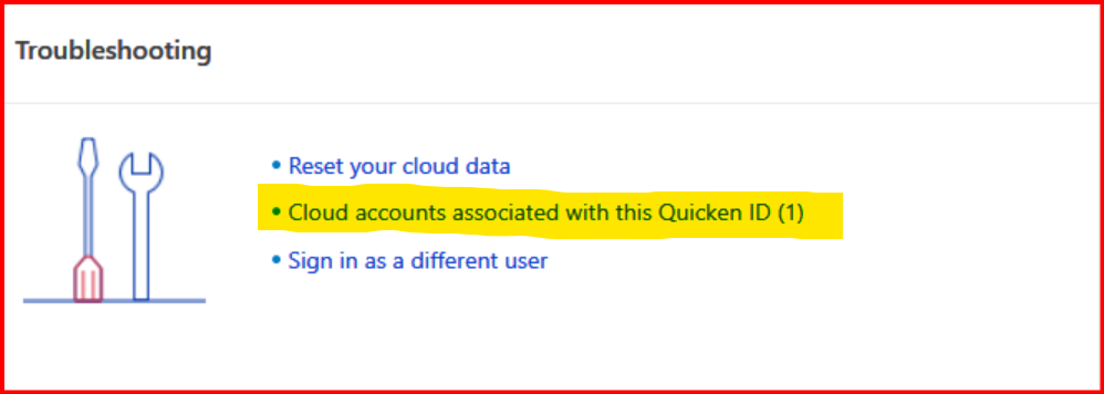

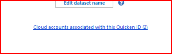

    LifeHub (and have indicated that there seems to be some kind of overlap with the Quicken Cloud dataset) - I just noticed the phantom cloud file recently. I am guessing it is for LifeHub, but I cannot see it. It shows correctly in the Mobile and Web tab -
    But in Preferences, it shows I have 2 cloud files, but when I click into the link, it only shows 1.

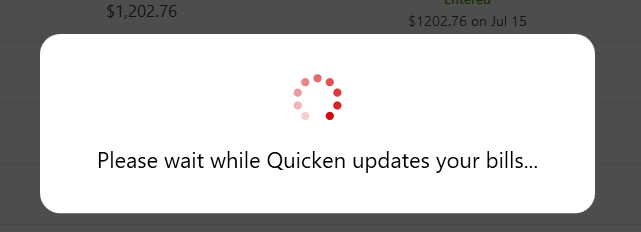

    OK, I misunderstood, I was looking for an "Update All".
    For me it did that for a few seconds and then it went away.
  • @Chris_QPW what version are you on? I reverted back to R63.21 and yes it only takes seconds and disappears. In R64.19, it took a half hour to an hour to complete.
  • And again, after that the OSU and cloud sync took a half an hour to an hour to complete.

    Thanks for sharing all the details. We did some testing with R64.19 while Quicken LifeHub was connected, and we weren’t able to reproduce the issues you described. From what we’ve seen, LifeHub itself is not causing conflicts with R64.19.
    Regarding the “phantom” cloud account you noticed: that’s expected. What you’re seeing is the entry for Quicken LifeHub. It’s not a traditional cloud dataset like the one used with Quicken Classic, but it does appear in the same place since it uses the same underlying system.

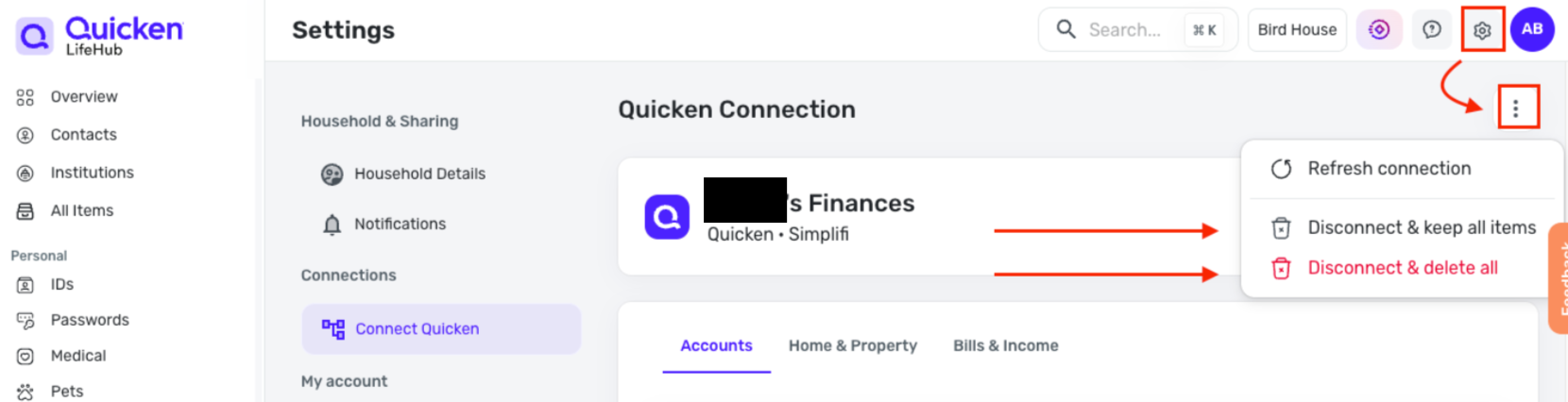

    If you’d like to confirm whether LifeHub is a factor in your case, here’s a good test approach:
    2. Update Quicken to R64.19 and see how it behaves.
    3. If everything runs smoothly, reconnect Quicken LifeHub and check again.
    Based on our internal testing, R64.19 and LifeHub work together without issue, but this process could help narrow things down on your specific setup.

  • @Quicken Anja I did disconnect in LifeHub this morning, but then the phantom cloud file did not go away in Quicken. So I then uninstalled LifeHub, but then it still hasn't gone away and is still there.
  • @Chris_QPW maybe I should just turn syncing off at the global level and leave it there. But in my troubleshooting yesterday, I thought I did and I still had issues.
    As far as uninstalling LifeHub, I did do that this morning. I was just starting to use it so there wasn't much data in there.

  • @Chris_QPW I made sure to chose "Disconnect and delete all". All of the accounts and balances were deleted.

  • @Quicken Anja LifeHub has been uninstalled, but the phantom cloud file is still out there.

    @CaliQkn Just to clarify—when I suggested disconnecting/reconnecting LifeHub, that was only meant as a way to test whether LifeHub was affecting overall Quicken performance. It won’t have any effect on the “phantom” cloud account you’re seeing.
    That entry is expected behavior once LifeHub has been connected at least once. Think of it like a history record—it’s not an active cloud dataset like your Classic Quicken file, but it still shows up in the same place since it uses the same system. Disconnecting LifeHub won’t remove it, and it will stay visible. It only disappears after a long period of inactivity (around 2 years after the LifeHub subscription expires). If you’d like it removed sooner, you’d need to reach out to Quicken Support directly as it requires an escalation.

    Did One Step Update with no problem. Did "Update All" on the Bills tab and the message about syncing went away at the same timing as before, but then it just totally locked up Quicken. Based on what I see it looks like Quicken has put up some kind of blocking dialog that isn't showing on the screen and that didn't "go away". The result is a grayed out main window that you can't click on (beeps when you click).
