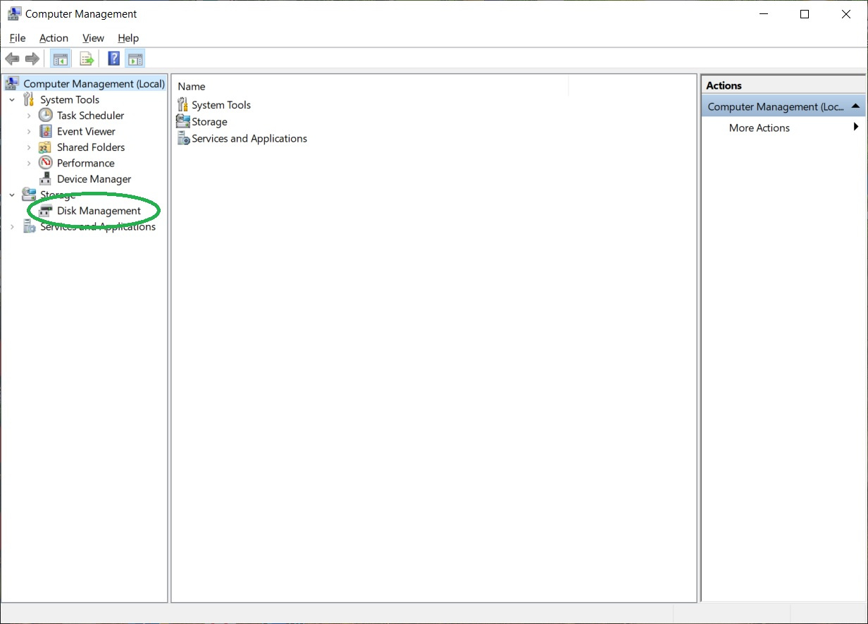

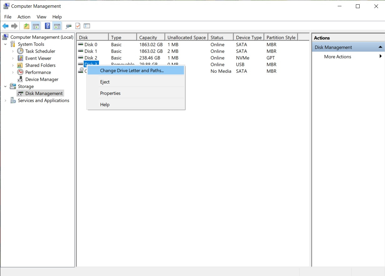

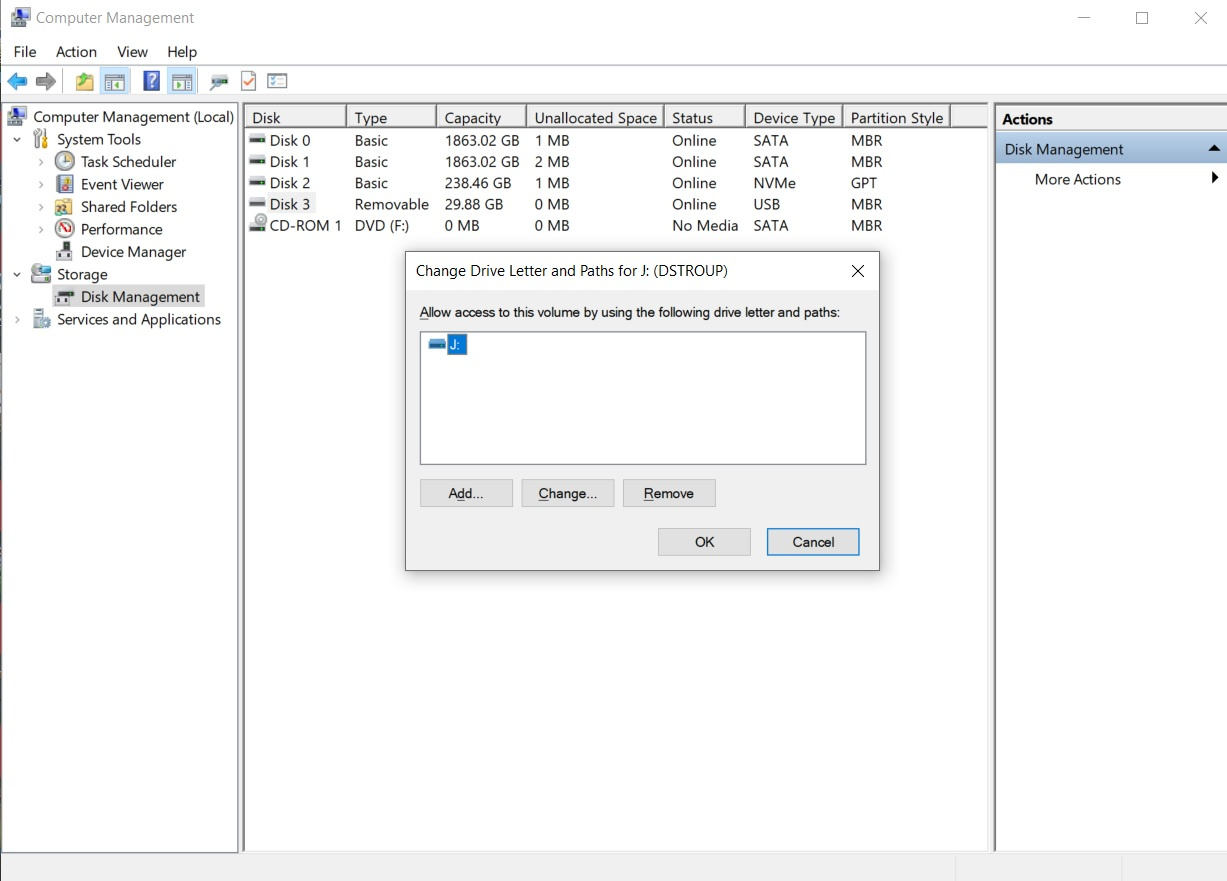

@splasher @CNESTER You can assign a drive letter to a flash drive, just like a regular drive, and it will maintain that letter until changed again by the user. This is done as an Administrator in the Windows Administrative Tool, Computer Management. Open Computer Management and click on Disk Management on the left side (Under Storage). Right click on the drive to assign, reassign, or remove the drive letter. You don't have to hope that the laptops will randomly align the drive letter. I'd suggest Q: - for Quicken - so the addition of another temporary drive likely would not upset your systems' normal drive organization (typically in the lower alphabet letters A: - F:). Here's an example using a 32GB flash drive (disk 3), already with a drive letter, J:.
