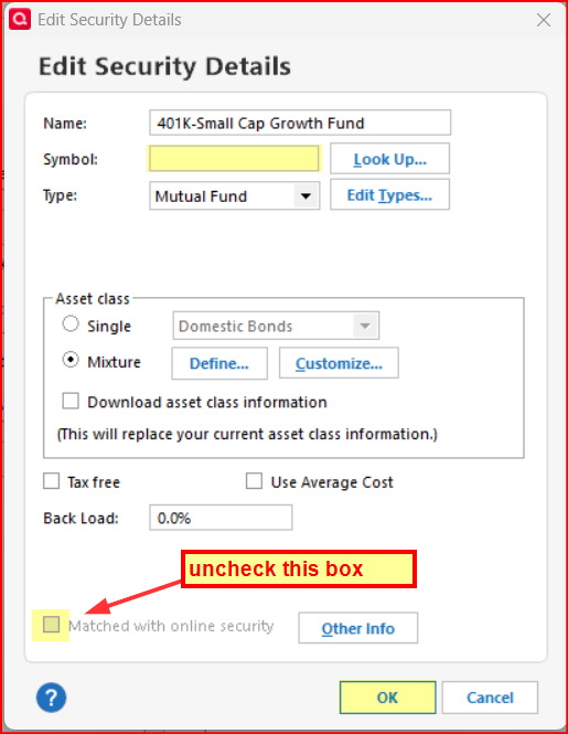

It's common for a 401(k) to use "trusts" instead of mutual funds. For these, you can set the asset class to "Mixture" on the Edit Security Details page to enter the percentages manually and uncheck "Download asset class information."

Because of this the ticker for the publicly traded fund does not apply to the private 401(k) fund and should be removed from the Security details in Quicken so incorrect security pricing and data is not downloaded. You can do this by going to Edit Security Details and removing the Ticker Symbol and unchecking the box for matched with online security.

@Boatnmaniac I think your recommendations are a little off.
With securities that are not publicly traded, it is correct to remove the ticker symbol. We should also un-check the Download quotes box for the security in the Security List. This will prevent Quicken's quote provider from downloading the price for the publicly traded version of the fund.
But if the fund is held in an account that is set up for transaction downloading, you should not un-check the Matched with online security box. That would prevent the transactions and the correct price from downloading from Voya.
To set the asset classes in Quicken, you should un-check the Download asset classes box in the Security Details and enter the correct asset class mixture manually.

It's been so long since I last had to deal with this kind of issue that perhaps my memory has failed me some. I was thinking that the incorrect CUSIP ID would need to be removed and the only way I know of to do that is to uncheck the box for Matched with online security.
I was also thinking that Voya would download the security information for their private fund which could then be matched to the existing security adding the correct CUSIP and perhaps the correct asset class.
Am I misunderstanding this?
Perhaps we are both right.
It is not clear whether the OP's Voya account is set up for downloading, or whether they also hold the publicly traded VTSAX in another account.
In any event, they will have to stop Quicken's quote downloads for this security and set the asset classes for the fund in the Voya account manually. The correct percentages should be the same as for the public Vanguard fund.
