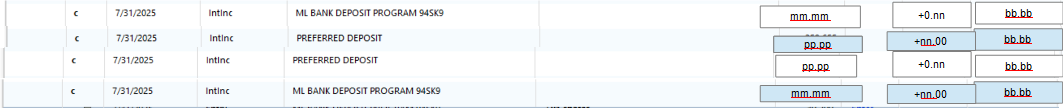

Another example, in additiont to the 2 IRAs, I have an ML brokerage account that also has cash that earns interest each month. That account has all the interest payment transactions from before and after the switch to EWC(+). But the transactions after the switch to EWC(+) look markedly different from those before. How could this be if the Direct Connect interest transactions look the same as the EWC(+) interest transactions? (Well, they could look identical but Quicken could decide to process them differently - but that doesn't make sense to me.)

re: your brokerage account. HOW do those transactions look different? Screen shots (JPG or other graphic format please) would be helpful.

Berfore EWC(+) i.e. Direct Connect:
After EWC(+):
A little explanbation: the account has two cash holdings (ML BAMK DEPOSIT PROGRAM and PREFERRED DESPOSIT) that are whole dollar shares. With Direct Connect I got two interest transactions: one that had the combined whole dollar amount of the interest and 1 that had the combined change of the interest. After EWC(+) I got whole dollar and change interest transactions for each of the two accounts.
Associated with the transition to EWC(+) was the addition of the two cash accounts to the holdings without subtracting the combined values of those two holding from cash. (Those two holdings have existed for some time.) So cash was amost double counted in the balance making the balance of the account wrong and driving me to start the referred to thread. The above screen shots are in that thread.
