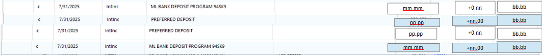

    I had a dividend posted today. As expected it went in both the ML Bank Program and cash. Well, it did so when Quicken recognized the difference between ML Bank Program number of shares in Quicken vs. reported by ML and I chose to create a placeholder transaction.
    Unfortunately it was a whole dollar amount. So I couldn't see what would happen to the cents portion of the transaction.

    Well, I just got a dividend for $60.06. So not a whole dollar amount. That resulted in an increase in ML Bank Deposit of $60 but an increase in cash of $60.06. I looked on line, I could not find my $0.06 anywhere!
    This would seem to me to be more of a question for ML. Anybody know what is going on here?

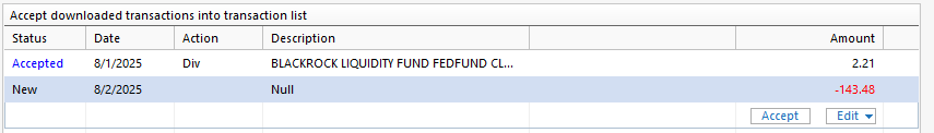

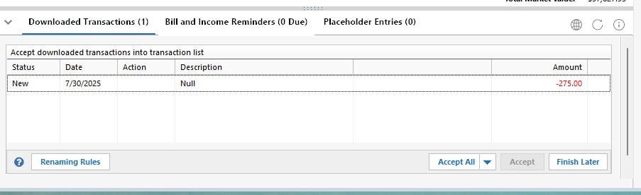

    Something else weird happened with my ML account. One of my IRAs is managed and they charge a fee. That usually comes in as a withdrawal action with Description and Security = "Advisory Program Fee Inv. Advisory Fee mmm" where mmm is the first three letters of the month. Invariably it appears in OSU on the 2nd of the month.
    Well, this month (August) it appearred on the first with Description and Security = "Null". I checked online and there is a pending withdrawal transaction with same amount and trade date of 8/2/2025 and description of "Pending Fee" and a settlement date of 8/4/2025.
    Again looking on line, July's fee has description of "Advisory Program Fee INV. ADVISORY FEE JUL" with trade and settlement date of 7/2/2025.
    I am sure that this new behavior is not what is expected or desired. I am going to hold off doing anything until after OSU's on 2nd, 3rd, and 4th - but I am sure I am going to have to take some action to fix it.
    Is this related to the reauthorization issue? (It is the first advisory program fee since the reauthorization.)
    I know that somewhat recently Quicken added some feature to deal with pending transactions but I have taken no action to activate that.

  • jtemplin
    jtemplin Member ✭✭✭✭
    I noticed the same issue this morning as well. Below snips are 1) the downloaded "Null" and 2) what is on the ML website for that transaction. It will be interesting to see what happens when the monthly advisory fees change from pending. Will they download again? We shall see when the settlement date occurs in a day or two.
    This is all baffling to me as a software engineer. You'd think that the code that was used to prepare the downloaded transactions in Direct Connect would have been reused to prepare the transactions for EWC+. Below are the two issues I've discovered so far.
    Here's the advisory fee downloaded as "Null" (the dividend shown is OK and not germane to the discussion)

  • Quicken Kristina
    edited August 2025
    Thank you for your replies @jdparker225 & @jtemplin,
    Thank you for letting us know about fees downloading with "null" in the description. I have forwarded this to the proper channels for further investigation and resolution. If you haven't already done so, please navigate to Help>Report a Problem and send a problem report with log files attached to contribute to the investigation.

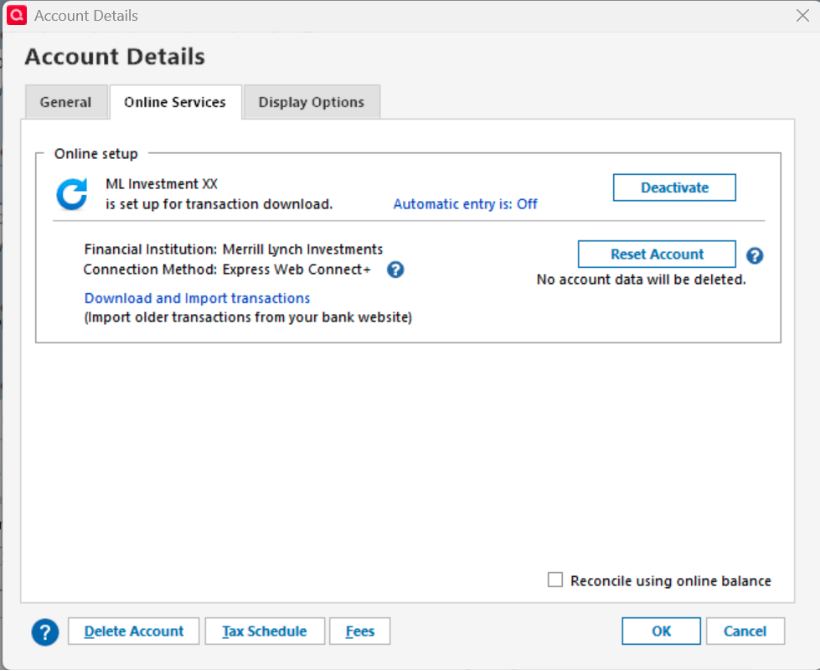

    I'm not entirely sure why, but this seems to have resolved all the issues. I spoke with support, and they had me switch the Merrill Lynch accounts back to "Direct Connect" instead of the "Express Web Connect+" that was enabled during re-authorization.
    To make the switch:
    1. Go to Tools > Account List.
    2. For each Merrill Lynch account, click Edit, go to the Online Services tab, and click Deactivate.
    3. Once all accounts are deactivated, repeat the steps and click Activate instead.
    4. You'll be prompted for your username and password—save them to the Password Vault.
    5. Make sure to link each account to the correct existing account.
    After this, you should be back on "Direct Connect." This cleared up all the errors for me.
