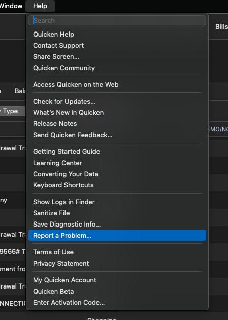

    Unfortunately, given that the steps in the article did not resolve the issue, you will need to contact Quicken Support. In preparation for your call, you can go to Help>Report a Problem from within your Quicken software.
    This will allow you to send your log files to Quicken, which will be needed for further escalation.

    We have forwarded this issue to the proper channels to have this further investigated. In the meantime, if you haven't already done so, we request that you please navigate to Help > Report a problem and submit a problem report with log files attached and (if you are willing) a sanitized copy of your data file in order to contribute to the investigation.
    Thank you.
