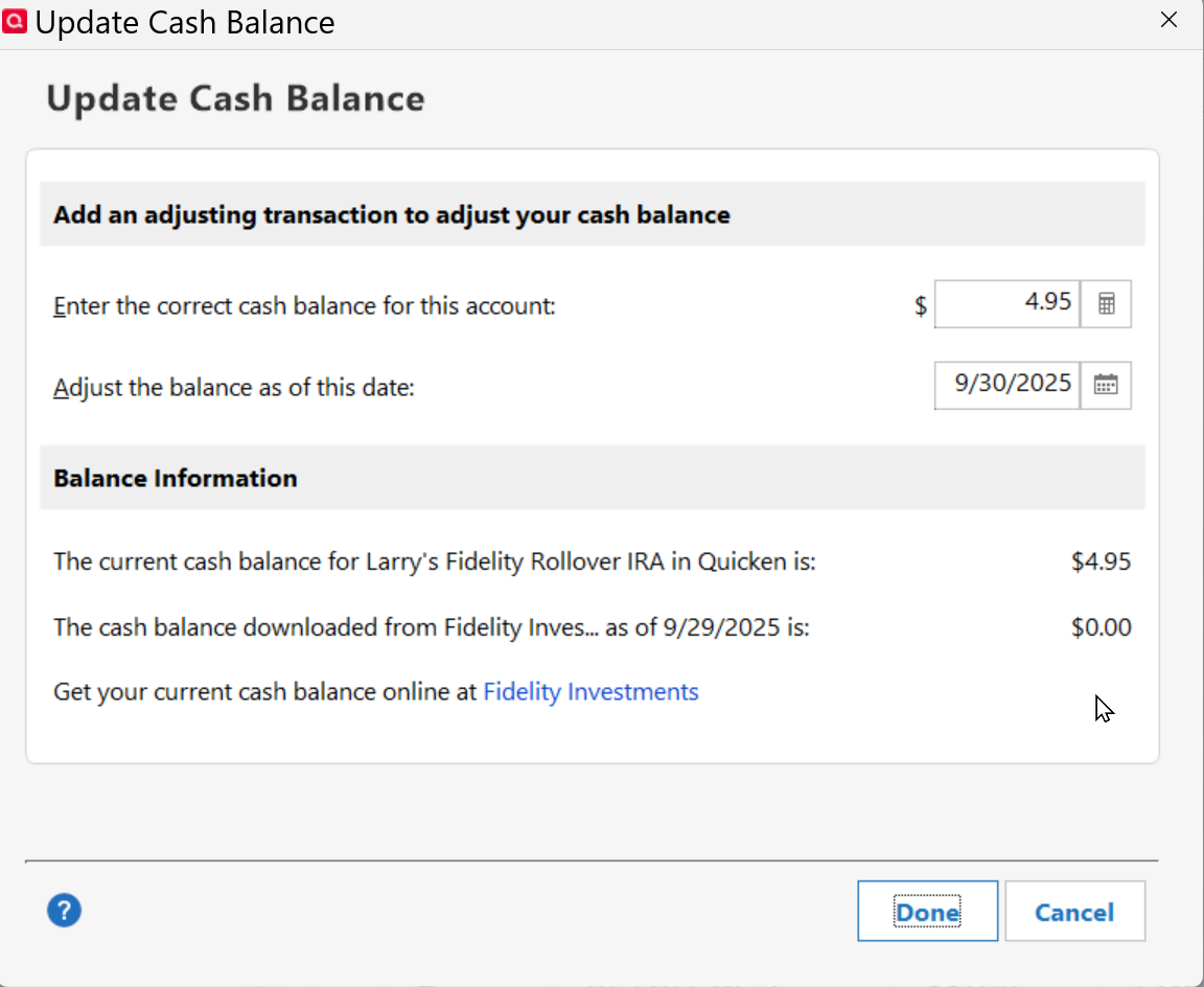

I converted to the new connection method a week ago (roughly), manually fixed the cash errors in 2 of 5 accounts and now this morning am in an unending loop of "reauthorize" which mostly fails and even if it appears to work, it doesn't download transactions and then immediately goes back into the "reauthorize" required and fail….. [Removed - Language/Rant]

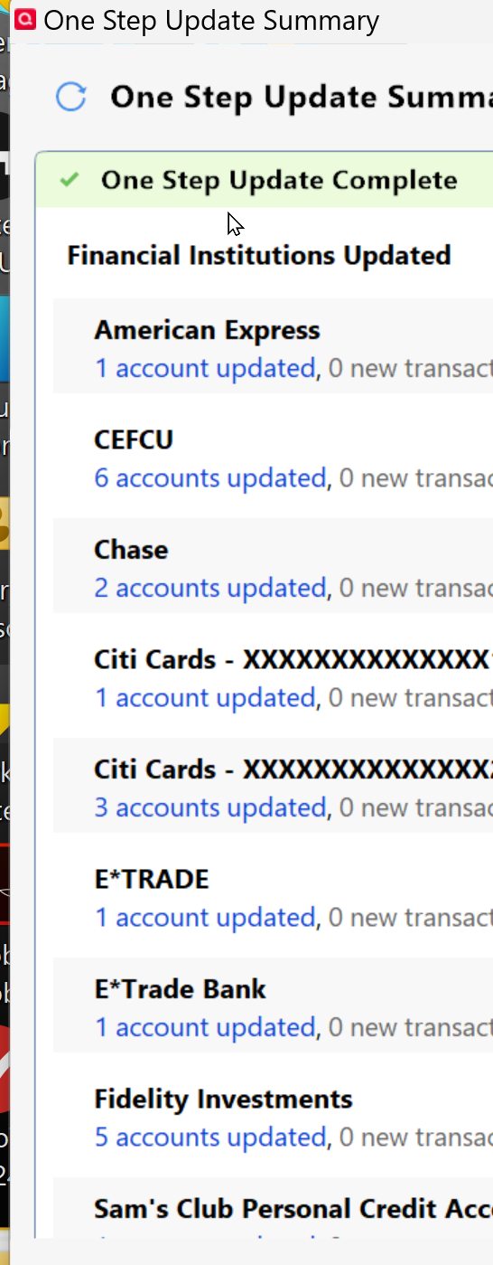

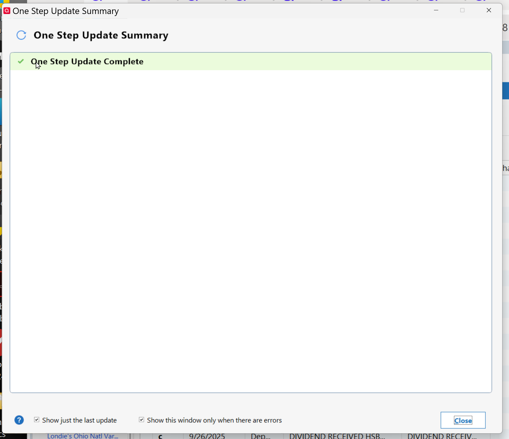

One problem I am now seeing is none of my EWC+ accounts (Fidelity, Credit Union, CITI Cards, etc) are showing a status in the "Update Summary" after I perform OSU.

I'm glad to hear it did finally reconnect. Getting a blank One Step Update Summary screen usually indicates an issue with the runtime.dat file. To resolve this issue, please navigate to this directory in your Windows system:
C:\ProgramData\Quicken\Inet[folder with your data file name].
The Program Data folder is hidden by default. If you need instructions on unhiding the folder, you can find instructions on Microsoft's support site.
Once you're in that directory, rename the runtime.dat file found at C:\ProgramData\Quicken\Inet\FILENAME\.
After you have renamed the runtime.dat file, run a One Step Update (OSU) again to confirm the issue is resolved.

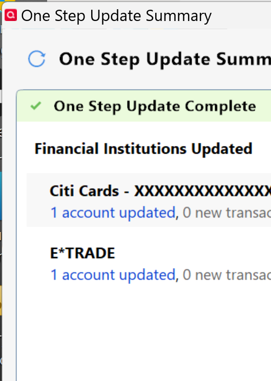

Thanks for the suggestion. I renamed runtime.dat, opened Quicken, ran OSU which completed. However OSU Summary page only displayed my 2 DC accounts and none of my several EWC+ accounts. Also the EWC+ accounts usually take several seconds to process, but they completed rather quickly.
I did a search and I see a second runtime.dat file in the C:\programdata\quicken\inet\common folder too.
Should I also rename that in addition to the the one within my C:\programdata\quicken\inet\"filename" folder?
UPDATE***
I went ahead and renamed the runtime.dat files in both folders, same results, only my 2 DC accounts are displayed in OSU Summary?
UPDATE 2 ****
I tried updating each Account one at a time. I selected an account, went to setting gear, selected Update Transactions. Each time the update processed, and that on Account appeared in OSU Update Summary. I did this for all my accounts, checking the OSU Update Summary each time for a correct result. I also had one case were a transaction was downloaded. After doing this for ALL my EWC+ accounts, I ran the OSU with all EWC+ and DC accounts selected and all processed and appeared on OSU Update Summary.
