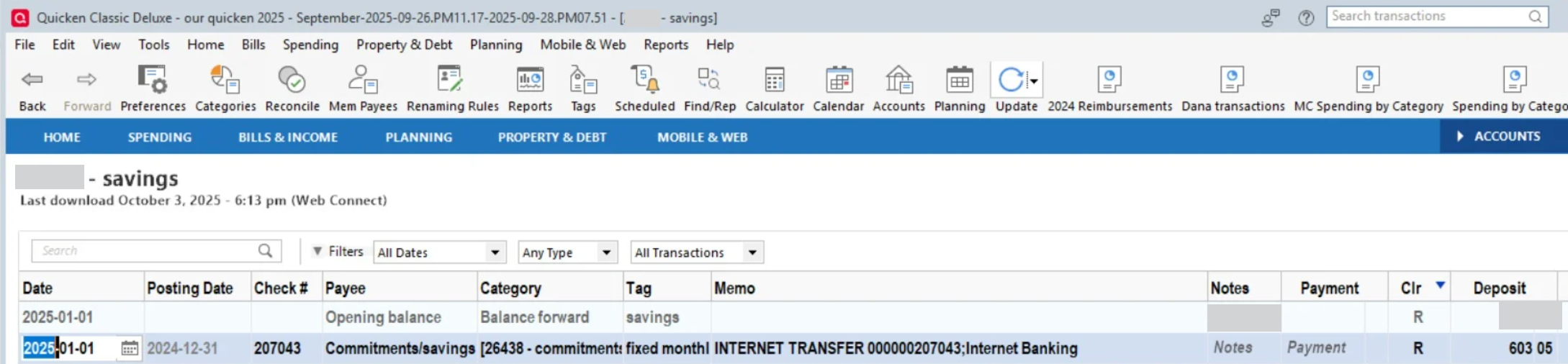

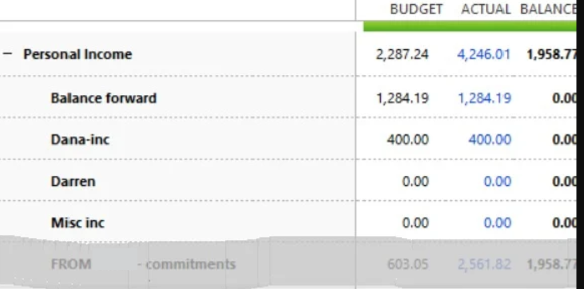

I'm using the Canadian version of Classic for Windows. I have several accounts for different purposes. I often transfer funds from Commitments to Savings. In the example below, I am transferring '$603.05 from commitments to savings. However, in the savings budget, the amount shows as $2,561.82. Clicking on this amount, I see that it is the total of three transactions in commitments. What can I do so that the budget only shows the $603.05 transaction?
[Edited Screenshots for Privacy]

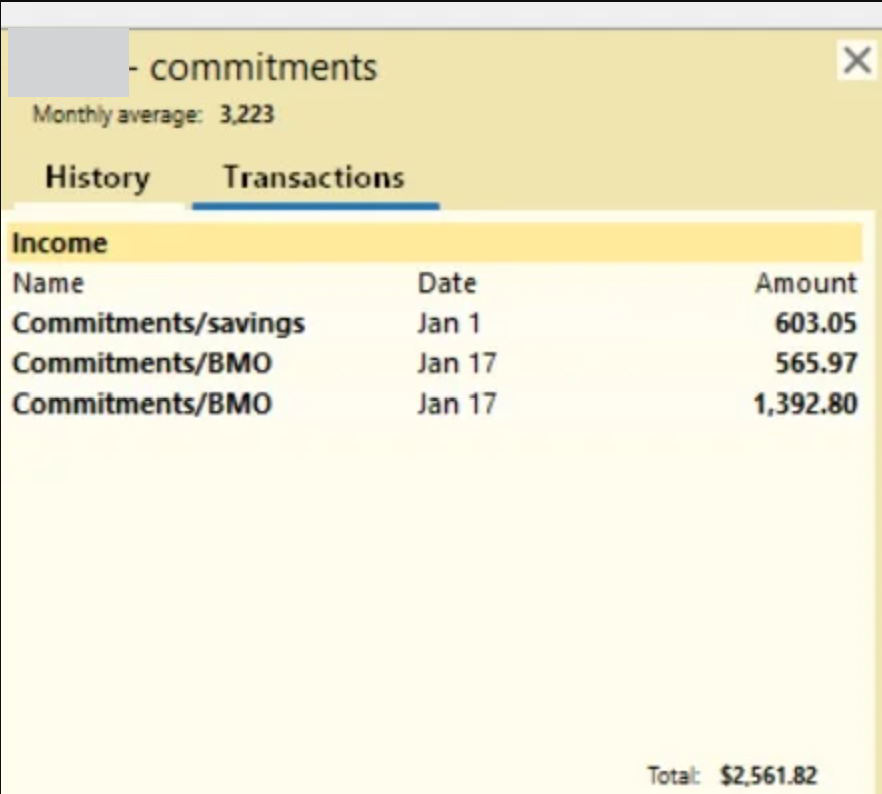

Hello @wpg 51,
Thanks for sharing those details and screenshots!
The budget calculates all transactions that use the same assigned category. In your last screenshots, it looks like there are two transactions with the payee name Commitments/BMO, which suggests they’re using the same category as the Commitments/Savings transaction.
Please click one of the Commitments/BMO transactions to open it in the register, then check which category is assigned. If it’s using the same category as Commitments/Savings, that would explain why it’s being included in your budget total.
Let us know what you find after checking—that will help narrow things down further!

I think I found a solution for my initial post where the total of all commitment transfers showed up in my savings budget. I set up a budget report using the same information as the budget to try out my theory and it worked. In the budget report, I could use the payee "commitments/savings". The total amount shown was the amount only transferred to savings. If the budget had the capability of using payees, the amount entered would match more specific criteria. I can now create my budget using the BMO and savings accounts to show all expenditures and only the amount I want transferred in. Does this seem possible to you?
Thank you for responding to my post. I was already doing what you suggested. In my savings budget, I only want the amount from commitments that pertains to my savings account. Unfortunately, the amount that shows is the total of all transfers out of the commitments account. The screenshots in the first post explain this more explicitly.
I found an even easier solution. Take the amount shown minus the budget amount and create a new transaction using the category transfer out. This then decreases the amount in the budget to where it should be.
@wpg 51 Thanks for sharing your follow-up and the solution you found! It’s great that you were able to adjust the budget by creating a compensating transaction to get the totals to match. Your approach of isolating the transfers that actually affect the budget will likely help others facing the same issue with linked accounts.
Budgets in Quicken can get tricky with transfers and multiple accounts, so practical workarounds like yours are always valuable to share in the Community.
